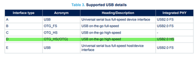

Hi @Davit_Imnaishvili
I guess they have already answered your question. you can find more about on-chip Hi-speed PHY on F723xx, STM32H7Sxx8 TM32U5Ax ... and more still not referenced in AN4879. You can filter them in Table 4. USB implementation in STM32 devices: D interface
Best regards,
FBL
BarryWhit
Lead II
NUCLEO-U5A5ZJ-Q
