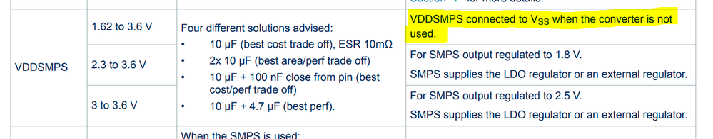

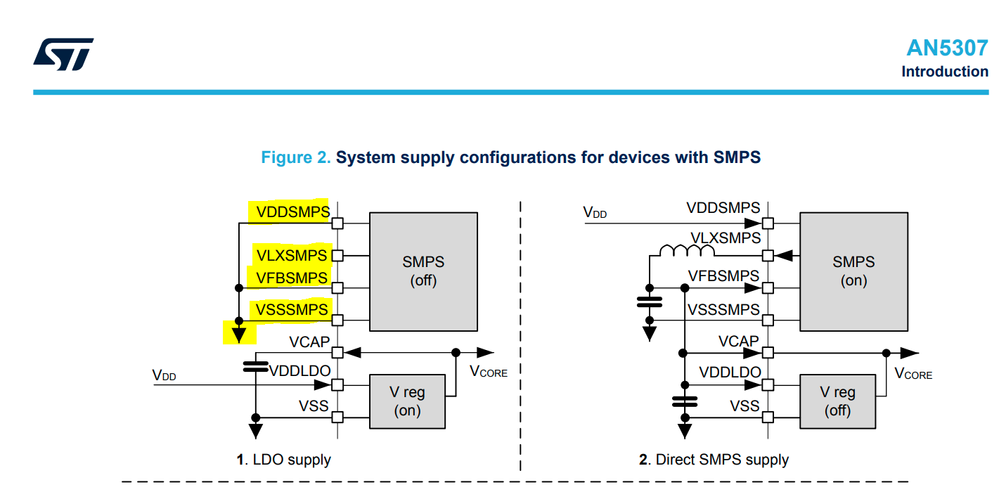

I don't use the internal Step Down regulator. How should the pins be tied?
Should VDDSMPS be tied to VDD and VSSSMPS to GND with VLXSMPS and VFBSMPS left open?
OR - should they ALL be left open?
Documentation only speaks as if they are to be used - no comments on what to do if not used.
TDKBest answer
Jan 11, 2022 5:38 PM UTC
This app note for STM32H7A/B shows them as grounded/floating. Can't imagine it's different for the H745.
https://www.st.com/resource/en/application_note/an5307-getting-started-with-stm32h7a37b3-line-and-stm32h7b0-value-line-microcontroller-hardware-development-stmicroelectronics.pdf

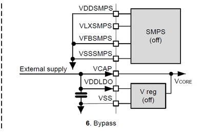

is the same solution possible for the STM32H747XIH6?
I want to fully bypass the internal LDO and SMPS.
Thank you-
mƎALLEm
Oct 8, 2024 4:08 PM UTC
 STM32H747 and STM32H745 have the same config from power settings point of view.
