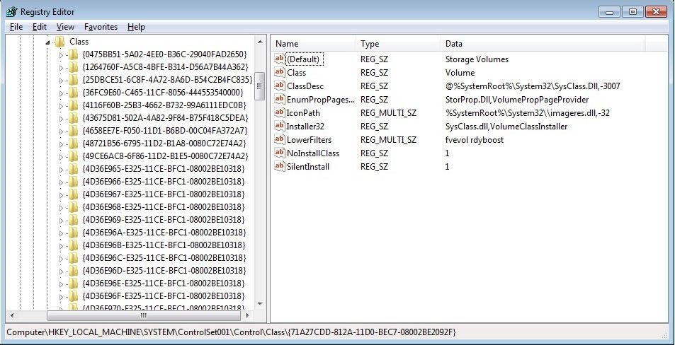

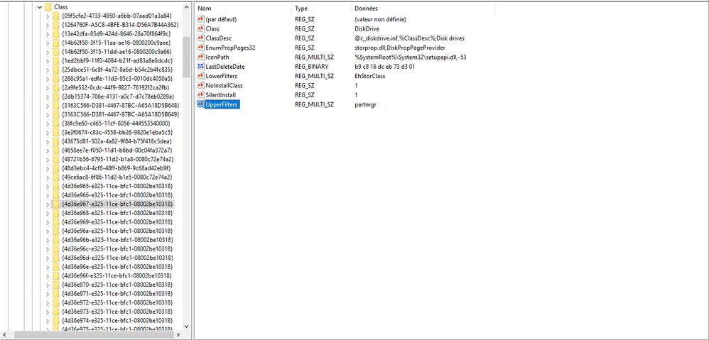

Posted on April 11, 2018 at 18:01
>>What do you mean ?
Dell Laptop vs Acer Desktop vs HP Workstation
I'd use REGEDIT, or whatever, and search HKLM for ''UpperFilters'' and ''LowerFilters''
