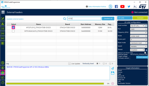

Could you please check the memory flash size, page size, dummy cycle...
Are you able to upload a .bin file using the available external loader in STM32CubeProgrammer without issue?
I hope this help you.

‎2024-07-08 3:29 AM
Yes, I'm able to upload .bin file using the external loader available in Cube Programmer.
But the custom file which I created is giving us this issue.
‎2024-07-08 5:45 AM
Hello @NKuma.20 ,
Glad to know that you are able to upload .bin file using the external loader available in STM32CubeProgrammer.
I noted in the .ioc file that the flash size "23" is wrong and should be "27". Please check the dummy and page size.
I recommend you when create your customer loader to start with an available example like as MT25TL01G_STM32H743I-EVAL and to follow the steps shared in How to implement and use your own external flash l... - STMicroelectronics Community FAQ.
Could you please share the project for checking?
Thank you.
