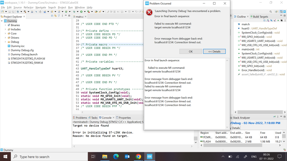

Error in initializing ST-LINK device. Reason : No device found on target.
AR K.1
Hello @ST_community,

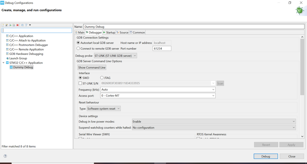

I am Trying to program STM32-H7A3ZI-Q Nucleo board.
I couldn't debug the board attached the images for reference. Also Attached the log file for reference. Please let me know how to debug.

Suggests the MCU is non-responsive.
Did you program it previously?
Does it work with STM32 Cube Programmer as a stand-alone application?
If you have the LDO/SMPS settings wrong you can block access to the STM32.
The trick then is to solder a jumper between BOOT0 (BT0) and VDD.
With BOOT0 HIGH remove ALL power and USB
Reapply power/connections.
Attempt to access via STM32 Cube Programmer.
If that succeeds, ERASE your code from the part.
Fix your code.
