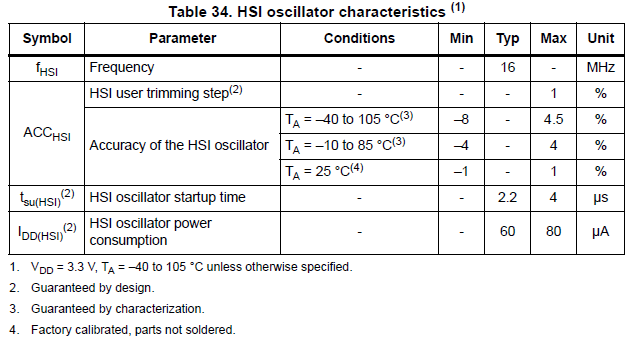

Do I need an crystal Oscillator?
Ala
Senior
The external crystal is needed only for USB, or when some timing task requires better accuracy than HSI.
E.g. as an asynchronous UART requires 5% accuracy, it might not work reliably in extreme temperatures.

berendi
Principal
Check the electrical characteristics chapter in the reference manual, both for ADC and the HSI internal oscillator. If they are adequate for your need, then no external components are needed apart from the decoupling capacitors.
Also read AN2834 How to get the best ADC accuracy in STM32 microcontrollers

S.Ma
Principal
The internal frequency HSI has some tolerances across chips, temperature etc... you will get a min-max range from this.
Now check if all your peripherals are ok with this.
Using USB? Need probably HSE
Using high speed UART? Need probably HSE
Using RTC? Need probably 32.768kHz HSI
