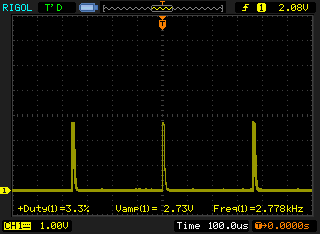

I have tried for more than a week to get the internal D+ pull up resistor to activate on my custom board.
I have checked the clocks and they seem to be all running. I created a new project with only USB OTG FS hid class enabled. STMCube v1.12.
When I probe the D+ pin I get the following.
_legacyfs_online_stmicro_images_0693W00000birPyQAI.pngIt took me a while to find the point where the process is started and that is in
  * @brief  USB_DevConnect : Connect the USB device by enabling Rpu
  * @param  USBx  Selected device
  * @retval HAL status
HAL_StatusTypeDef USB_DevConnect(USB_OTG_GlobalTypeDef *USBx)
  uint32_t USBx_BASE = (uint32_t)USBx;
  /* In case phy is stopped, ensure to ungate and restore the phy CLK */
  USBx_PCGCCTL &= ~(USB_OTG_PCGCCTL_STOPCLK | USB_OTG_PCGCCTL_GATECLK);
  USBx_DEVICE->DCTL &= ~USB_OTG_DCTL_SDIS;
  return HAL_OK;
If I put a break point at line 13 the output on the D+ pin PA12 remains low, but when I step to the next line the output appears is in the image above.
When I repeat the same exercise, but with the STM32H767 the D+ pin PA12 is pulled all the way up to 3.3V and I can see the burst pulses coming through from the host.
If I add an external 1.5kOhm resistor to my custom board with the STM32H743ZIT6 the host responds as with the F767 device.
I am attaching my setup code and hope someone can see what is wrong.

Thank you Amel and Jan for the response.
I found my bug not in software but in the hardware.
There is only a 100nF on VDD33USB. For some reason I had it that the power supply to the USB core would be internal and the only additional component would be a 100nF cap. After adding a 3.3V supply to this pin my two week long search was over.
What really confused me was the activity and the D+ pin so it seemed like all was well.
In my understanding of self powered and bus powered it was refering to the controller and not the USB core. I now have it self powered with the onboard 3.3V source and it is working perfectly with the code in my original post.
Thanks again for coming back to me. You guys are great!
Try the same exercise (i.e. breakpoint and one single-step), without being connected to host.
And, for illustration, try the same (again, breakpoint and then one single-step) with the 'F7.
