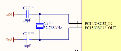

Hello everyone, this is my first post on the forum. I'm starting to learn STM and have created a custom board using the STM32F405RGT6. This is the first board I've created, and I wanted to check for any errors before sending it to production. So I've uploaded a PDF of the connection diagram. I'd be very grateful if you could review it and let me know if there are any mistakes.

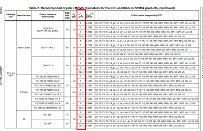

Need to re-check this part of LSE:
Did you check if the crystal is compatible with the STM32? did you calculate the gain margin based on the crystal characteristics and the load capacitors?
Read How to select a compatible crystal and load capacitors for STM32 with layout guidelines
18pf CL looks a bit high compared to the CL recommended for LSE for STM32 in the AN2867 :

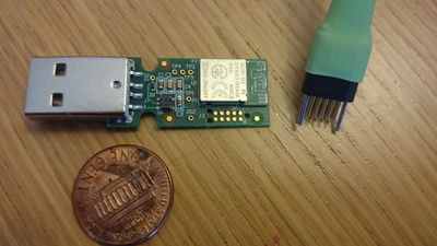

So how do you plan to debug it?
Omitting this capability is a Really Bad Idea!
You don't have to provide a full-sized header - could be just test points accessed with "pogo pins"; eg,
See https://www.tag-connect.com/ for that particular connector.
The absolute minimum for SWD is just 2 connections - data & clock - but it's best to also include RESET.
Again, Design For Debug !

Thank you. I was using a 32.768 kHz ±20ppm Crystal 12.5pF 70 kOhms 2-SMD, No Lead. I will replace it with an FC-135R 32.7680KA-AG3 and use an 8.2 pF Capacitor.
