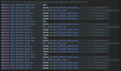

You're answer is true and is shown in the CR2 register cmsis header file (stm32g031xx.h):
However, I'm still pretty lost here. I probably should have phrased my question differently.
Because 0x00 is for gpio PA[m] how do I change this register to make PA8 the interrupt? using the provided formula m=(4 * (x -1))  where x is 8, m = 28. does this mean I need to make bit position 28 a 1 in this case? The RM calls the 8-bit sections EXTIm, EXTIm+1, etc... this confuses me because, as you said, CR3 (CR2 zero base) is EXTI8-11. which doesn't work with anything related to 28 that I can see. Not to mention CR3 is also m+2.

Simply put, there's an array of 32 bytes, where each byte controls one EXTI source, nicely consecutively, so the byte at offset 0x60 selects between Px0 pins, byte at offset 0x61 for Px1 pins etc For purposes of documentation those registers are shown in groups of 4 as words. This grouping then results in the numbering confusion. However, EXTI registers *are* bytewise accessible, see beginning of the registers description subchapter, so going for that might perhaps result in less confusing notation.
PS. For PAx, you don't need to set the respective EXTI mux selection at all, as 0 is its reset-default state (unless you want to swap between the sources in runtime).
Note that EXTICR3 is EXTI->EXTICR[2], not 3. Zero based indices.
Yeah, but only when using the array index, not when using the register names. So EXTI_EXTICR3_EXTI8 is for EXTI->EXTICR[2].

It means you need to set the EXTICR3_EXTI8 field to 0 (all zero bits).
Your original code should be changed to the following:
/*Select PORTA8 for EXTI*/
// clear all bits in EXTICR3_EXTI8
EXTI->EXTICR[2] &= ~EXTI_EXTICR3_EXTI8;
// set EXTICR3_EXTI8 field to 0 for port A
EXTI->EXTICR[2] |= 0 << EXTI_EXTICR3_EXTI8_Pos;
(Or do nothing as @waclawek.jan suggests as GPIOA is the default.)
