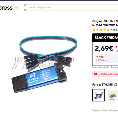

I've never used STM32CubeProgrammer or a ST-Link V2 so I don't know what it should look like. I've bought the one at this link https://www.aliexpress.com/item/33010611392.html

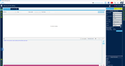

When I open  STM32CubeProgrammer  and click "connect" nothing happens, apart from the message in the log window
The serial number is shown as "E"
Do I need to do something to make this device work? Or where can I buy one that works out of the box?

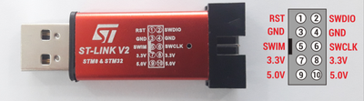

So all the ones that look like a USB drive are not original? I though the original ones also looked like that and that it was difficult to tell them apart

The ones you get from official reputable suppliers are genuine. Other ones are likely not, especially if they are considerably cheaper.
There is no official product that looks like this, so they are all knock-offs:

Next time, if you buy a cheap "clone st-link V2" , look at the user comments first, here at your device:
"probably Geehy APM32 S103CBT6 " .
So this will not work as st-link , because no STM chip inside.
So buy something genuine, like a NUCLEO board from mouser , or check the comments....all !  , before you buy something  from somewhere unknown.

i just looked at Ali..this seems (!) ok :
https://de.aliexpress.com/item/1005006160511992.html
in comments : " original stm32f103c8t6 "
BUT: the dealer might not know, what he is selling, it might change, so its just like a game.
