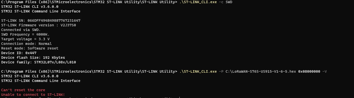

Can't program hex file from ST-LINK CLI but works on STM32 Link Utility with same parameters ? Keep having 'Can't reset core Unable to Connect to ST-LINK' error

(On Nucleo L073RZ devkit with target on SWD) I can easily connect and program a hex file from the stm32 link utility UI but it seems impossible from the CLI. Connection parameters are the same (Mode: Normal, Reset Mode: Software system reset) and the
.\ST-LINK_CLI.exe -c SWD
command works fine, but not
.\ST-LINK_CLI.exe -P C:\LoRaWAN-S76S-US915-V1-6-5.hex 0x08000000 -V

UPDATE:
Altough I didn't quite see such infoin the CLI documentation, I've found out that the connection command only connects to the target for the duration of the command and close the connection after, making it impossible for the program command to work.
FIX:
Just 'pipe' the 2 commands and it should work perfectly:
.\ST-LINK_CLI.exe -c SWD -P C:\LoRaWAN-S76S-US915-V1-6-5.hex 0x08000000 -V
