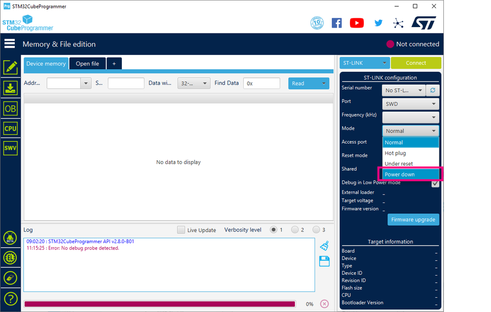

I've been working with the STM32H7B3LIH6Q board on Segger, and it was functioning normally until I happened to flash the code below to it. Now I get "no idcode detected" on Segger and "No debug probe detected" on STM32CubeProgrammer when connected to ST-Link. In fact, connecting the ST-Link module doesn't even power the board. I made sure the correct power pins were shorted too. I then tried changing the on-board switch (aka boot0) to 1:sys-mem and power cycling several times but I still couldn't connect. The JLinkSTM32 utility doesn't seem to work either and some of the other utilities also seem to be unable to connect.
Is there any way to reset the option bytes or flash memory? Maybe using JLinkExe to enter direct commands? I feel like I've almost tried everything and it seems somewhat ridiculous to me that a board would be so poorly designed that setting the clock frequency too high in software (I didn't realize 400 MHz was too high) would irretrievably brick it, if that's what happened.

Hi @FSkro.1​ ,
Can you please tell me if you are using ST board?
If yes , to recover the board I can suggest you to try connect board in power down mode :
For the second part of question I let STM32H7 expert answer, @Imen DAHMEN​ can you please help to tag the right person ?
Hope this helps you.
