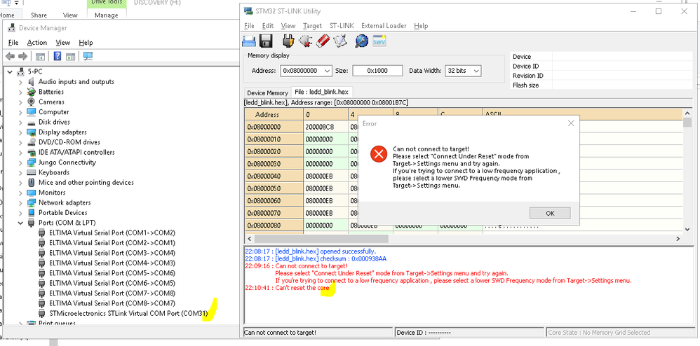

i am working on STM32L0538. but getting some errors while connecting to stlink utility. and leds and e paper display is not getting ON.
Fpina.1
1 REPLY 1
Is the code perhaps going into a low power mode, or disabling the debug pins?
Can you perhaps use a debugger, and follow what's happening?
