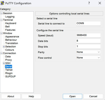

I can confirm the port is not in use by STM32CubeMonitor-Power when I try PuTTY.
Here are the settings I use:

Do you see the COM port in Device Manager ?
What, exactly, happens when you try to use PuTTY ?
Abdessamad
I see the COM port in the device manager.
however on putty i am not able to send any command (it is not responding to keyboard input), the window stays open without any activity.
previously on the 1.0.1 firmware version, i got welcome message when using putty.
Abdessamad
I have the same output from putty.

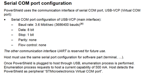

Show a screenshot of your PuTTY settings - are you sure it supports that baud rate?
Here are my settings.
I also tried with lower rates, but same issue.
The documentation mentions the following: "On host USB virtual COM port, configuration of baud rate may be not needed since replaced by USB maximum baudrate"
Your previous screenshot showed COM3; now you show COM9 - which is it ?
