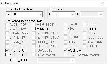

I am developing one small application, using STM32L011F4 MCU. As I realised from datasheet, there are two ways to boot from flash memory:
1)Connect PB9-BOOT0 pin to ground;
2)Set nBOOT_SEL bit and use nBOOT0 bit instead of BOOT0 pin.

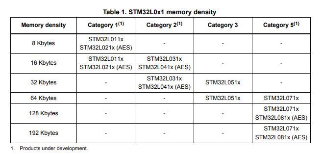

Also, datasheet says that nBOOT_SEL bit available only for Category 1 devices.
Again, according to datasheet, STM32L011F4 is category 1 device:
The problem is that I can not program nBOOT_SEL bit using ST-LINK UTILITY, it is shown in gray color and I can not check/uncheck it.
What could be the problem?
Try the STM32 Cube Programmer, it is the software they have migrated too.

STM32 Cube Programmer works fine, thank you very much.
