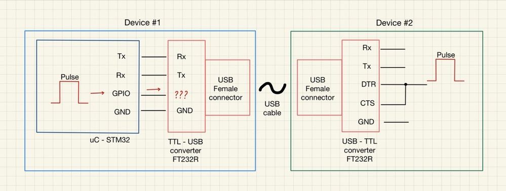

I'm currently trying to receive some data from device #2 (legacy device, not a PC) with my uC STM32 (device #1). But in order to receive the data I need to generate a pulse in the DTR pin or CTS (both are connected in the device #2) on the converter USB to TTL of the device.
I can communicate with the device #2 using the serial communication software like Docklight Scripting by using the Manual RTS/DTR control but I need to do this with the STM32 and for that I am using the USART1 of the STM32 that will be connected to a TTL to USB converter as shown in the [Figure1] where I setup a GPIO to connect to the RTS pin of the converter of the device #1, where I want to generate a pulse of x milliseconds in the CTS/DTR of the device #2 but it doesn’t work.

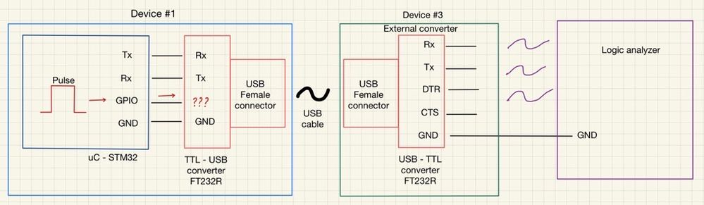

So, my second attempt was to connect an external converter (device #3) to the device #1 and check all the pins of device #3 with a logic analyzer to see if I manage to generate a pulse in the DTR or CTS pin of device #3 but it didn’t work. I even connected the device #3 with the software Docklight scripting and I can see the pulse generated in the DTR pin with the logic analyzer when I press the DTR button in the software.
I'm thinking I need some kinda drivers to detect the COM port of the converter but I am not sure if I can do this with directly from the STM32

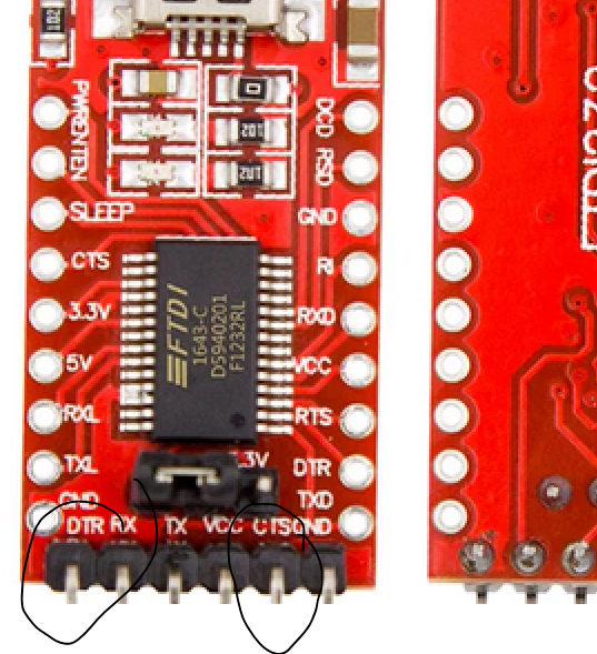

0693W00000YAmcoQAD.pngHow are you connecting those lines, maybe post some pictures or wiring?
hit me up in https://www.linkedin.com/in/javiermu%C3%B1oz/
Well, I have two options to use USART - USB bridge or directly the USB peripheral. But I abandoned the USB peripheral option because I don't know how to generate the pulse on the CTS pin of device #2. If you know how to do this with the stm32 built in usb peripheral library and if it works I can discard the usart to usb bridge option.
