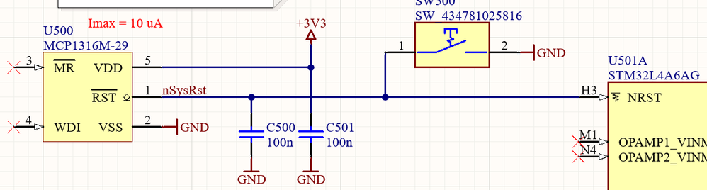

  • The NRST pin is connected to a 100 nF cap to GND, open drain output of MCP1316M (i.e. voltage supervisor) and to a button. The voltage supervisor will release the reset line as soon the supply voltage goes above 2.9 V (I have removed this component to make sure that it's not this one who triggers the reset, but it didn't change its behavior).

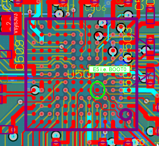

Hehe, "UN"fortuantelly its a 169 pin BGA :> Nope, I made already many electro-surgical intervention to inner layers, but I don't think so that I will be able or nearly successful to get to that pin from the other side.
0693W00000WI1g7QAD.pngFor sure this is an issue. And it (maybe) explains the issue I have, when starting up the boards that actually work (i.e. when powering it, even with having a voltage supervisor that releases the reset pin not before the voltage reaches 2.9 V, I have to pull down the reset line manually with the attached reset button).
But how would you explain, that I still can run the debugger and run a few lines of codes? I mean, now having this pin floating the uC eventually will detect it as either being "high" or "low". Consequently I would either be able to run it fully functionally and maybe when turning it on a second time it wouldn't work at all, as the BOOT0 eventually makes it decide where to search for the program to run. Wouldn't you agree?
Sorry for insist for further explanation and not simply check that first. The problem is, that I'm unable to rework that on the current board (as visualised above) to check if that helps. I will have to order a new design having this BOOT0 fixed. But as this is going to be expensive in any case, I would want to find a plausible answer to all symtoms before spending the next batch of money. I hope you understand.
