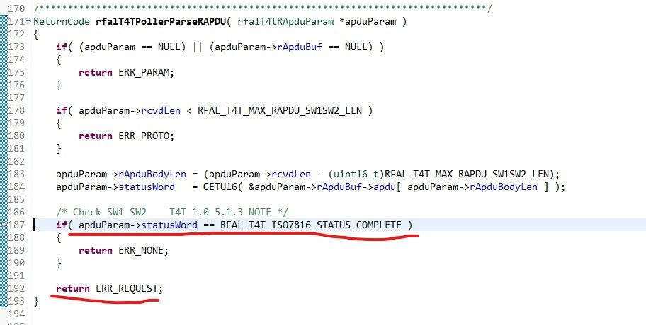

I have boards - NUCLEOL476RG and X-NUCLEO-NFC06A1 with project "STM32L476RG-Nucleo_PollingTagDetectNdef" running on it.
And got an error when trying to read any tag:
When debugging program i found that error, its here in the code, doesn't match
apduParam->statusWord == RFAL_T4T_ISO7816_STATUS_COMPLETE
The walue of statusWord is 27266 instead of 36864 (0x9000)
Appreciate for help and sorry for my english))

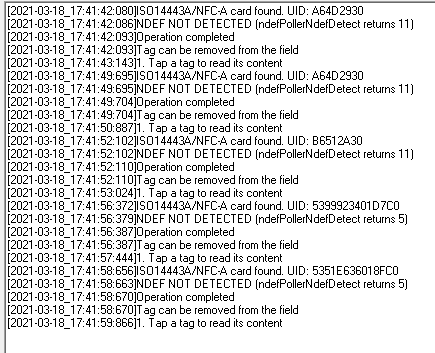

NDEF can only be read/written from NFC Forum formatted tags. Not all tags are capable of that. Above indicates you are using NFC-A tags supporting ISODEP/ISO7816 APDUs.
The value 27266=0x6A82 indicates that this tag does not answer success (0x9000) to the command. I think 0x6A82 means "not supported. I assume this to be the response to the "Select NDEF application" command. NFC-A smartcards are available for a plethora of applications, e.g. NFC Forum T4T, EMVCo, Passport, .....
If you use tags like ST25TA which implement T4T it will report success.
Best Regards, Ulysses

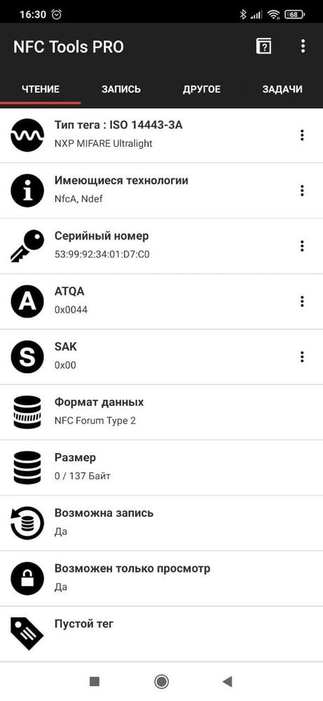

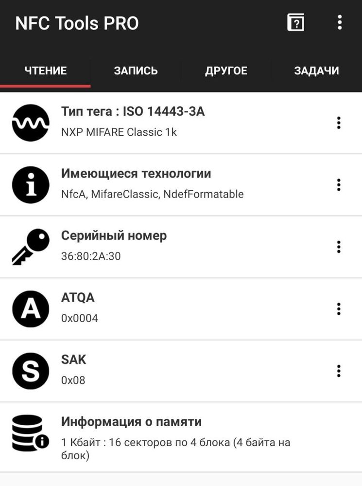

Those messages you see on the picture I got using 2 types of tags: NFС 1К s50 F08///716 Вytеs and ntаg213/137 Bytеs.
But I also used smartphone and app NFC Tools Pro and there was again NDEF NOT DETECTED message.

yes: not all NFC devices support NDEF format. Even if maybe some of the devices you are using actually support NDEF it may still be needed to format them for it. For formatting you need to consult with the manufacturer.
Regards, Ulysses

NTAG213 have factory supporting NDEF .
See NXP site
I have successfully reading and writing these tags using smartphone (NFC Tools app).
But problem is that X-NUCLEO-NFC06A1 board can't read or write these tags, and so my phone in card emulating mode (using NFC Tool app).

One difference may be that the X-CUBE-NFCx demos are not swiss army knives with built-in knowledge for various available tags. They can read and write pre-formatted NFC Forum tags T2T, T3T, T4T and T5T. They can also format ST25(T/D)V tags as T5T.
The NFC Tools app seems to be more of debugging tool with main support of NXP tags, e.g. not reading an SRTAG64K and not able to format ST25TV.
You mentioned the NFC Tools app to be able to do card emulation. Didn't find this feature. Can you give me some guidance. Is this only available in Pro version?
If an NTAG is formatted - has a correct CC (Capability container) then also our demos should be a able to read/write NDEF onto those tags. If this is not the case then please share it memory content (E.g. NFC Tools: Other -> Read memory).
If a tag is properly formatted as NFC Forum tag then no app is needed to read it - Android will do it. In this case I expect also our X-CUBE-NFCx to read it.

I've tried to format (whatever it means in that case) my tags (NFС 1К s50 F08///716 Вytеs and ntаg213/137 Bytеs) by NFC Tools app but its failed, it doesn't support this tags.
Yes, card emulation is available in Pro version, its in the WRITE menu --> ADDITIONAL OPTIONS.

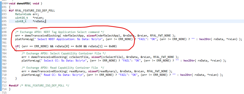

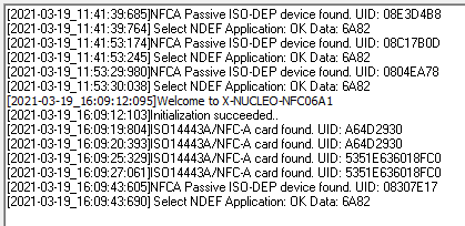

I also tried project named "STM32L476RG-Nucleo_PollingTagDetect" (without "Ndef" in the end). And have output:
ISO-DEP its my phone.
OK Data: 6A82 it means that "Select NDEF Application" command failed (result must be 0x9000). See the code:
