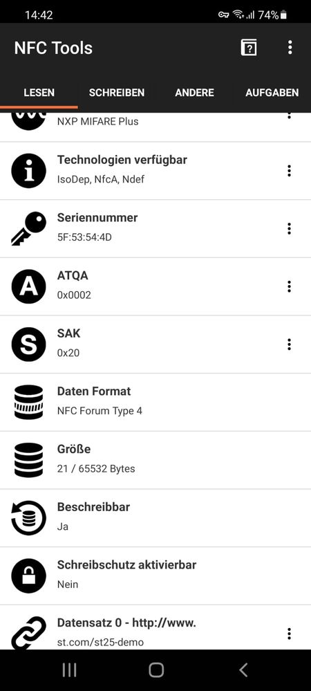

in my experiments both T3T and T4T worked for reading NDEF: Define ST25R3916 and change the line discParam.techs2Find |= RFAL_NFC_LISTEN_TECH_F; ->        discParam.techs2Find = RFAL_NFC_LISTEN_TECH_A;
This is for v1.1.0 of X-CUBE-NFC6.
Similar for v1.0.0: Set discParam.techs2Find = (RFAL_NFC_LISTEN_TECH_A );

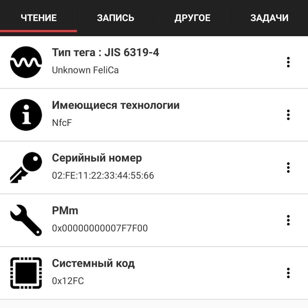

You said that T4T working, how you recognize it? Phone polling both NFC-A and NFC-F simultaneously (and maybe more tech's) and if both technologies are enabled on the board, then only NFC-F is recognized by the phone, so I disable NFC-A here:
0693W000008xn9vQAA.pngBut if I only enable NFC-A, it is also recognized as NFC-F, but the label content (payload) cannot be read, that's all avaible info:

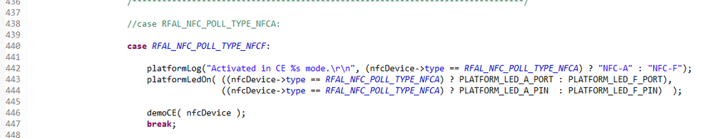

Just checked,
i uncomment
case RFAL_NFC_POLL_TYPE_NFCA:
in demoCycle() function, i.e. i enabled NFC-A tag mode, and run debug, and find out that program doen't entering in demoCeT4TRead() function and even in demoCeT4T(), so NFC-A mode doesn't working for some reason.

the trick should not be playing with the state machine but just change techs2Find.
Please try the attached hex, it was compiled according to my above instructions.

I used your hex and the result of reading the label is the same as yours. I did as you said, changed tech2find and I recognized the NFC-A tag, okay. The writing is more difficult, the text or URL is written in ndefFile, I looked in debugging, but the problem is that when reading the label in ndefFile, the default entry is written again - the address of the page st25demo.
