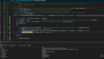

Understood - I set my rx buffer to a fixed size of 1024 bytes. When I do that and use iso15693WriteBlock to perform my write operation then I get a TIMEOUT error. Here's a screen shot of my debug session showing the actual code I'm using:
Questions:
Why would I get a timeout when there's nowhere to specify a timeout in that method?
I have assumed that writing a block is a slow mode command and have therefore not selected fast mode. Is that a correct assumption?
Ulysses HERNIOSUS
iso15693WriteBlock() internally applies default timeouts for NFCV write commands. I believe 20ms.
Getting first No Memory and now Timeout may mean that you may have overdone with going to 1K of bytes. Not sure if some layers in between can handle 1K buffers. Better if you try with e.g. 20 bytes.
Fast mode may only speed up the sending of the write command. I expect a not so big effect.
BR, Ulysses
TimLong
I have it working now. I used a brand new tag that was not password-protected to get it working without the added complication of having to unlock the tag, and then added back the unlocking code, and everything is working now.
I used the iso15693WriteBlock command, and that did actually appear to work with a 1024 byte rx buffer, nevertheless I trimmed the Rx buffer down to 32-bytes per your suggestion.
