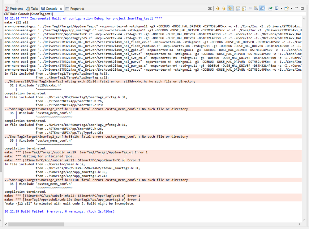

If I import example project in CubeIDE and complie it, It works fine.
If I want to create my own project and include libraries I get an errors during compiling.
So, I did the following:
- start new project in CubeIDE and select "STEVAL-SMARTAG2"
- set inputs/outputs as default (press OK when pop-up window ask me if i want to keep it)
- middleware/software package... download and select FP-SN-SMARTTAG2

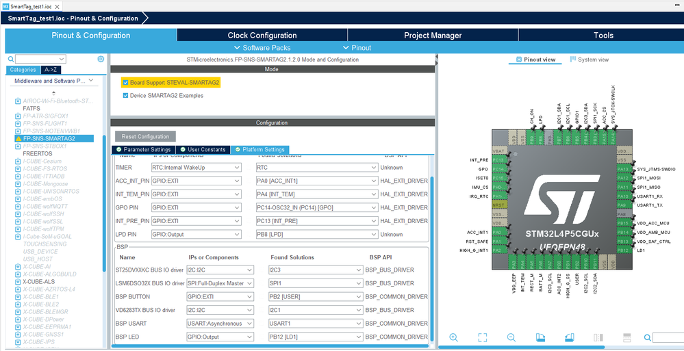

- define platform settings (picture below)
- save and run the compiler and get an errors (picture below)
It looks like I miss something?

Then, the details described are not sufficient to well identify the problem.
The file SmarTag_test1.ioc (STM32CubeMX configuration file for the generated project ) will be necessary.
What can be said is that:
  • In the first picture  "Board Support STEVAL-SMARTAG2" is in yellow color.
  • This means that a few components have not been included in the "Select Components" phase: I suppose NFC7 board extension and X-CUBE-MEMS1 driver components.
