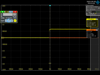

On an oscilloscope, I can see that the XOUT pin that goes to the crystal rises to just above 0.5V on powerup, but the crystal never begins oscillation (see attached image). I am using the XRCGB27M120F3M00R0 from Murata, which is 27.12MHz with ~150 ohm ESR and 6pF load capacitance. I will provide the schematic for the entire circuit for reference.

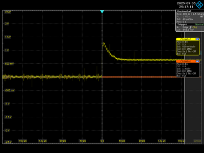

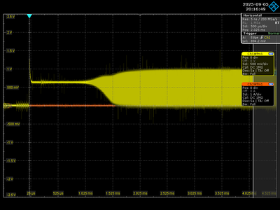

  • I will attach some scope traces to show the startup behavior and functional oscillation on the working project to compare with the non-working project. The exact procedure I followed is: I apply power to the board (5V, which gets converted to 3.3V through a linear voltage regulator which then powers the CR95HF), then I manually short the IRW_IN pin to GND to simulate the initial low pulse to start the oscillator. On the working project, you'll see that as soon as the IRQ_IN low pulse is received, the excitation voltage spikes up to ~1V, then settles to ~0.6V, and then a few miliseconds later the oscillation begins.
crystal_startup_working_project.png startup on the working project's board
crystal_startup_working_initial_turnon.png transient startup response on working board
crystal_working_oscillation.png oscillation on working board
crystal_startup_non_working_project.png startup on not-working project's board with the same crystal from the working project.
Update: I also tried swapping the CR95HF chips between the two boards, and this did not make any difference. The working project still works and the non-working project still does not start the crystal, despite the XOUT voltage being present.
On the last scope trace (non-working board), the time constant appears to be too large. Could you check the C55 and C56 capacitors for the correct 6 pF value, proper soldering, and other potential issues?
