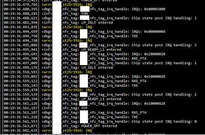

I'm working on emulating a T2T with my device. It successfully makes it through automatic anticollision, then starts looking for commands. When I see 0x30 0x00, I go ahead and send the first 16 bytes, but the reader does not react or show the read data.
Right now I'm thinking that I'm transmitting wrong while in Listen Mode. The RFAL never does T2T emulation, so I don't have an example there. Right now, when I see a 0x30 command, I do the following:
Send command CLEAR FIFO
Set Num Tx Bytes 1 to the MSB
Set Num Tx Bytes 2 mask 0xF8 to the LSB
Write the data to the FIFO
Send command TX WITH CRC
Is there a different way to do it in Listen Mode? With T2T Emulation the chip's field will never be on, but I don't see a way to explicitly modulate a response. The first 16 bytes are shown above, with the CC 0xE1 0x10 0x3F 0x0F. I do also have an empty NDEF TLV and the Terminator TLV, but no memory regions beyond the first 4 blocks are attempted to be read.
Also - I couldn't find any information on the INT2 byte after the second BCC, so I copied the 0x48 I've seen on NTAGs. What does that byte represent?

Yes, I'm referring to the manufacturer data (which I have to figure out how to set myself). The INT2 name comes from this Infineon spec, Block 2 Byte 1. The T2T spec from the NFC Forum just lists it as Internal9 and doesn't specify how to set it. The BCCs are Internal3 and Internal8, the BCCs of the previous section of the UID. I do think those 16 bytes are fine though.
So far as I can tell, the timing is all good. The IRQ comes in within a millisecond of "LM respond" in the below screenshot at 15.009,033. Then we read, and the transmit process completes at 15.012,145.
I'm using a Flipper Zero (which uses an ST25R3916) and a phone. I have a NUCLEO-L476RG + X-NUCLEO-NFC08A1 set up and it will transition my device to ACTIVE, but I'm not seeing the 30 00 come in so that's what I'll work on now so that I can actually observe it happening.
Just to check, in passive target mode, I should still be using Command Transmit with CRC, right? Does the chip see that the mode is set to ISO-14443A passive target and then transmit using modulation rather than generating its own field? Is the sequence I detailed above correct to respond as a passive target?

Got it, thanks. I've made some good progress on this, I didn't end up needing to implement T4T. When an Android phone is properly connected to the tag, it reads the data on it as expected using the NFC Tools app. The Flipper, for some reason, sends a bunch of non-T2T commands. From what I can tell, I should be responding with a 4-bit all-0s short frame for invalid commands, which I do, but the Flipper only moves on to the next command when I remove it and put it back into the field.
As far as the T2T I do have working - the main issue I'm seeing now is that the ST25R3916 rapidly transitions from POWER_OFF -> EON -> IDLE -> READY_L1 -> sometimes READY_L2 -> EOF -> POWER_OFF. It seems like it's not properly completing anticollision in most cases despite beginning it. It works most consistently when I have the coils very close and very lined up. I've also tried it with tags disabled in case that was messing up timing, and get the same result.
When the device is operating as a reader, it has a range of about 1cm. Should I be expecting the same range for tag emulation?
Additionally, are there more configurations than I'm seeing that would affect when the chip does/doesn't successfully complete anticollision? I set the peer field activation threshold to 150mV and the peer field deactivation threshold to 75mV to hopefully give it more bandwidth to stay alive, but that doesn't seem to have helped. As in the RFAL, I have Antenna Tuning 1 set to 0x00 and Antenna Tuning 2 set to 0xFF, as well as overshoot and undershoot protection disabled.
