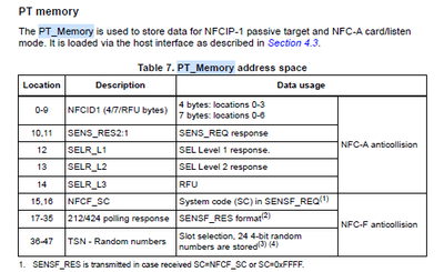

I'm working on emulating a T2T with my device. It successfully makes it through automatic anticollision, then starts looking for commands. When I see 0x30 0x00, I go ahead and send the first 16 bytes, but the reader does not react or show the read data.
Right now I'm thinking that I'm transmitting wrong while in Listen Mode. The RFAL never does T2T emulation, so I don't have an example there. Right now, when I see a 0x30 command, I do the following:

Inside the ATQA there are fields where a tag should indicate if bitwise anticollision is supported. I think you swapped the bytes in your ATQA, should be 4400, the 44h should be transmitted first.
So it is showing it as a tag fragment as no UID could be received.

Well, this is embarrassing, but that was it. I messed around with ATQA order when I was initially populating PT_MEM because I wasn't sure which went first, but I had left it alone since then.
Now it works with all three test phones: Pixel 6a, Galaxy Fold4, iPhone 14. (Flipper Zero seems to break something, but that's likely because it doesn't respect the tag information as part of anticollision since it's just a hobbyist device.)
Question on the documentation, then. The NFC Forum Digital Protocol specifies Byte 1 of the SENS_RES/ATQA as the one with size (0x44), and Byte 2 as T1T stuff (0x00). The ST25R3916 datasheet specifies that the SENS_RES is bytes 10 and 11, but in the order [2:1]. I interpreted this as meaning 0x00 goes first, then 0x44. Is that the incorrect interpretation, or is the datasheet wrong?
2024-10-09 1:38 AM
I think no order swap was intended in the text here and it just goes naturally out: Byte 10 being the first ATQA byte and byte 11 being the second ATQA byte.
I admit that this detail is not well written on the doc.
