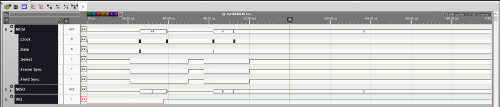

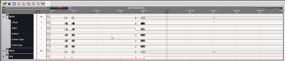

in my exeriments the iPhone SE 2020 always opened the URI. However using Samsung Galaxy S21 I see an immediate hang.
SPI trace shows the interrupt is stopped to be handled at some point, afterwards IRQ is constant high and no more SPI traffic:
Zoomed in a bit more to see the last frames:
I would suspect damaged locking of SPI (platform(Un)Protect...(). I would assume that it depends on timing - if interrupt comes while an SPI transfer is ongoing. That's maybe why it is happening with the iPhone at your side but not at mine.
Regards, Ulysses
