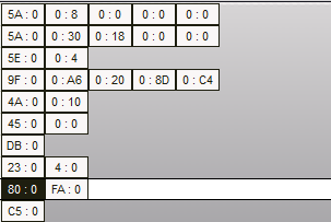

I have some traces showing r05h:0x80, r22h:0x00, r23h:0x04, FIFO getting 0xFA and transmission using C5 causing 4 bits being sent.

The following is a trace from the logic analyzer, showing a 4-bit acknowledgment being sent in card emulation mode:
Some devices, such as the Flipper Zero, emulate T2T tags. Refer to the Flipper Zero firmware source code for more details.

Thanks for pointing to the Flipper Zero code. It looks like it uses transparent mode to send 4 bit short frames.
I am sending the same sequence of commands you have shown in your logic analyzer trace. But the chip sends 8 bits instead of 4. Do you have a trace of the actual load modulated signal or the data received at the reader end to confirm it actually sends 4 bits?
