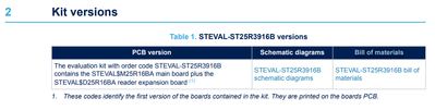

I can't find a specific recommendation for the external 27.12 MHz crystal. The link in the evaluation board for the BOM does not work anymore (leads to an error page).

About the crystal: For me I could get to the BOM. Please report which of the below links may not work for you:
  1. https://www.st.com/en/evaluation-tools/steval-25r3916b.html#cad-resources
  2. https://www.st.com/resource/en/bill_of_materials/steval-25r3916b-bom.pdf
  3. https://www.st.com/en/ecosystems/x-nucleo-nfc08a1.html#cad-resources
  4. https://www.st.com/resource/en/bill_of_materials/x-nucleo-nfc08a1-bom.pdf
If you followed a different link, then please let us know.
BR, Ulysses
oh thanks.
I'have tried to open the BOM link via datasheet of the STEVAL-25R3916B Board. That still doesn't work for me. (https://www.st.com/resource/en/bill_of_materials/STEVAL-ST25R3916B_bom.pdf
that link does also not work for me. Seems to be an incorrect link in this document. Please try the links which I provided.
BR, Ulysses
