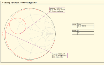

I have now tried a measurement with a VNA of the matching circuit with antenna. My VNA is connected at RFO1 and RFO2 directly at the ST25R3916b, driver output resistance is set to high Z. I have attached a screenshot of the measurement.

I had a look at my circuit and found some capacitors which did not have the same values as i originally planed. I replaced them and now i have definitely improved the RF Field. I have attached a screenshot of the new measurement with antenna tuning.

I used AAT to tune the antenna instead of manually tuning the caps mayself. I still have a imaginary value of 15.72 Ohm. Which capacitors do i have to change to reduce this ? Should i manually try to tune the capacitors instead of using AAT?

Currently, I am utilizing the antenna for which I provided the parameters earlier. After running your simulation, I replaced the components on the board accordingly. However, I encountered an issue with the tuning capacitors connected to AAT_A. They have a tuning range of 100pF to 200pF, but my new calculations indicate that I need to tune them to 67pF, which is unfortunately not feasible with the components I have on hand.
As a workaround, I decided to remove the tuning capacitors from the circuit entirely and replaced them with a single capacitor. Originally, from the simulation I had a 36pF capacitor in parallel with the tuning capacitor, which needed to be adjusted to 67pF. Instead, I have now used a 100pF capacitor in that position. The updated circuit can be seen in rfCircuit2.png.
I have also attached the measurement results with the new set of capacitors. However, it appears that the results are still significantly different from the simulation. Additionally, I included a picture of the PCB, highlighting the points where I connected the VNA and the antenna.

Thank you for the information you have provided.
After reviewing it, I noticed that the capacitor package size highlighted in yellow is different from the others. Could you please explain the reason for using a different package size for these capacitors? Larger capacitors may have slightly higher parasitic inductance compared to smaller capacitors, which can affect the impedance at high frequencies. Additionally, I noticed that you have added a tuning capacitor (C126) in the schematic, which is missing in the prototype.
Potential reasons for the discrepancy between the results might be:
  • Parasitic capacitance that is often not accounted for in simulations.
  • Incorrect calibration of measurement equipment (VNA).
Possible solutions you may try:
  • Optimize the PCB layout, ensuring proper grounding.
  • Include parasitic capacitance in your simulation model.
  • Calibrate your network analyzer before taking measurements.
  • Use low tolerance capacitors.
Best regards,
Blake

To verify my Vector Network Analyzer (VNA), I purchased a STEVAL-25R3916B and connected my VNA to it. The measurements I obtained look excellent, as expected. I have attached the measurement results.
My next step will be to calculate the parasitic capacitance of the PCB circuit and incorporate it into the simulation in Qucs.
