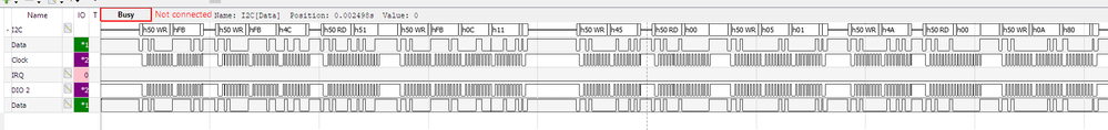

Indeed I just prepared some analyzer traces, which I attach here. First part is before the "1" second part is after the "1"s
The logic analyzer detects some errors (missing acks?), but for our MCU the communication is fine (no I2C errors detected). Also the payloads interpreted by the MCU match the ones on the analyzer, so I suppose that part is fine.

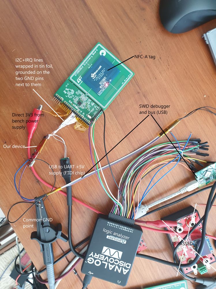

I shot a picture of the setup, I will upload it in a while, in the meantime I will try to follow your suggestions.

the Logic analyzer trace this time only decodes Error-Error-Error. I would try to twist the 4 wires going to the logic analyzer.
Regards, Ulysses
Yes I can, but it's not just "errors" in the trace.

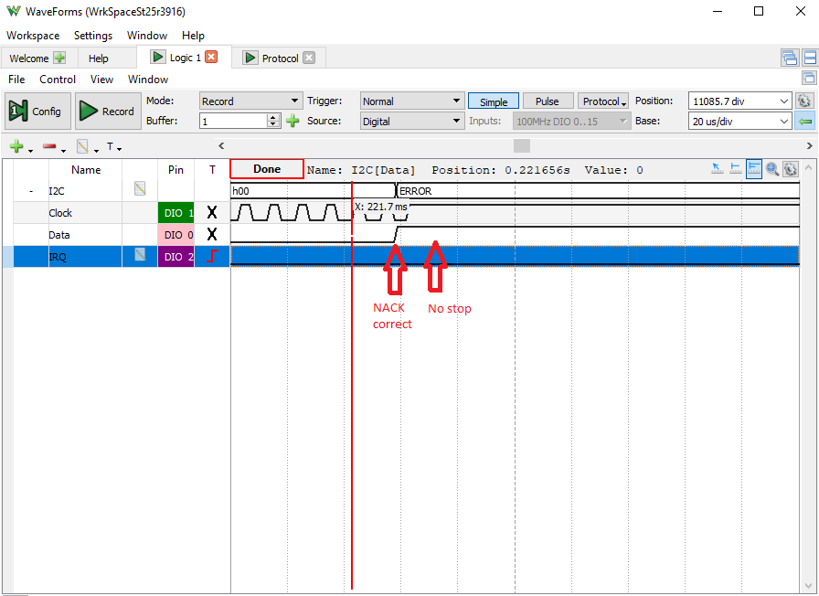

This is the beginning of firstpart.dwf3logic inside the .zip file. We actually just found out that most of ERRORs are missing STOP bytes after the 4 IRQ register read.
Do you see the same thing or you can't read my files properly?
This is what happens to me after last of the 4 irq register is read:0693W000000VIFpQAO.png

board init + NFC-A scan begin, now with:
-twisted I2C an logic analyzer wires;
-whole logic analyzer wires + I2C wires and MCU board wrapped in tin foil and grounded
-PM and AM gain reduced in init mode 10dB

my traces never showed real data but only Error-Error-Error which seems to have been a logic analyzer artifact: After removing the I2C decoder and re-adding it I could see useful data similar to yours.
As the NACK and STOP are generated by the master and immediately afterwards the task level performs I2C transfers I am suspecting a missing lock / premature unlock in your I2C code causing the missing STOP. From a first glimpse it seems not to cause bad effects but I would definitely repair this.
