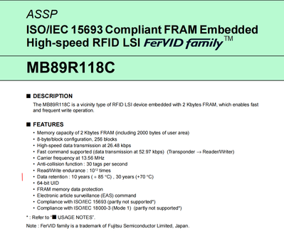

2024-12-18 12:53 AM

Compared with what you said, it takes me 9.1ms to use Read Multiple Blocks command and 7.3ms to use Fast Read Multiple Blocks command, both of which are slower than the theory.
But,The tag on the customer site may not support Fast Read, so I still have to use Read Multiple Blocks command.
Is this the fastest speed that can be achieved by using Read Multiple Blocks command? Is there any other way to improve it?I will provide you with what you need.
Finally, regarding the read multiple blocks unlimited proprietary command you mentioned, I didn't find this command in the demo. Where can I get this command demo?
Rgds
H
2024-12-19 1:21 AM
"Compared with what you said, it takes me 9.1ms to use Read Multiple Blocks command and 7.3ms to use Fast Read Multiple Blocks command, both of which are slower than the theory." the theoretical values are related to air transmission only. MCU / device communications over SPI (registers configurations, FIFO write and read) add some extra duration. So, your measurement are inline with the theoretical values + MCU / device communications duration.
"The tag on the customer site may not support Fast Read, so I still have to use Read Multiple Blocks command": please note that Read Multiple Blocks is an optional command from ISO15693 point of view so if your customer uses another tag, it may not support the Read Multiple Blocks command. It may also support another block size (e.g. 4 instead of 8 on MB89R118C) and may support a different maximum number of blocks for the Read Multiple Blocks command (when supported).
"Is this the fastest speed that can be achieved by using Read Multiple Blocks command?" Duration of the transmission on the air is defined by the standard.
"Is there any other way to improve it?"
"regarding the read multiple blocks unlimited proprietary command you mentioned, I didn't find this command in the demo" The read multiple blocks unlimited command is a proprietary command of the MB89R118C device. The demo provides the support of
Thus, the support of read multiple blocks unlimited command is not provided but one can easily add the support of this command.
Rgds
BT
