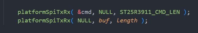

The issue I am having then arises in the next part of the example program. When I initially power the system, and put a tag close to the antenna, the program successfully detects it. It then moves forward to running the collision resolution routine. At this point the function return a value of 4 (ERR_TIMEOUT) and does not continue with the rest of the algorithm. It then goes back and restarts the process. This time, when I bring a tag close to the antenna, the function rfalNfcaPollerTechnologyDetection() always returns a value of 4 and never detects a tag again. After debugging the library, I figure out that after the tag is detected the first time, the field does not turn on anymore, even though the program runs through the code to turn it on. This would explain why the tag isn’t being detected anymore.
Debugging
I then began to step through the code to figure out exactly why this was happening. The only thing I was able to figure out was that when the system is initially powered on and no tag has been detected, the field turns on right after ST25R3911_REG_OP_CONTROL_tx_en bit has been set in the ST25R3911_REG_OP_CONTROL register (this step in the rfalFieldOnAndStartGT routine). Once a tag has been detected and the program sets the tx_en bit, the field does not turn on. I have verified this theory using an oscilloscope. Image nfc_field shows the signal before a tag is detected, and image no_nfc_field shows after.
My next thought was that maybe it has something to do with the interrupts. I began scoping the interrupt line along with the SPI peripheral. I observed that when the library is attempting to detect a tag, 2 interrupts happen. The first one is caused by the I_txe (IRQ due to end of transmission). The second is caused by I_tim (IRQ due to timer or NFC event) and I_nre (IRQ due to No-Response Timer expuire). This makes sense. Then when I bring a tag near the antenna, 3 interrupts happen. The first one is always the same, I_txe. The second one was caused by I_rxs (IRQ due to start of receive). And the third was because I_rxe (IRQ due to end of receive). This also makes sense. After that only 2 interrupts happen, and the cause is the same as the first explanation ( I_txe and (I_tim & I_nre) ). Here is where I observed something interesting. The time between the first set of 2 interrupts (before tag) was about 162us. After the tag was found, the time between them was 81 us. This was a bit odd to me and don’t know why the chip produces the interrupts twice as fast. I have attached 3 images to show the IRQ line during all three instances - irq_beforeTag, irq_tagDetected, and irq_afterTag.

I finally got the library to work. The issue was caused by NXP's way of implementing the SPI protocol. It turns out that within the library, there are a couple of instances where Tx and Rx are done in two separate transactions. This works great when you have control over the CS line, but since the NXP SDK controls this line with each call to their transmit function, both instances were being treated as two different SPI calls.
Given this information, when the program called st25r3911ReadFifo, the second SPI call overwrote the osc bit, which inevitably caused the chip to output the 27.2Mhz signal.
Solution
After looking through the documentation, I stumbled across the ST25R_COM_SINGLETXRX preprocessor directive, as you mentioned in your post. I enabled this and the library worked. I am able to detect tags now.

Brian,
I potentially found the culprit to my issue, but still working on a solution and maybe you can help me with this.
After probing the hardware I observed the following behavior on the RFO1 pin:
  • Upon power-on, no card put into the field, the frequency was 13.56Mhz.
  • After putting the card in the field, the frequency changes to 27.2Mhz. From this point, the frequency does not change back to 13.56Mhz.
This is a problem because the hardware (antenna) was tuned to work at the 13.56Mhz.
Given this change in frequency, it led me to believe that somewhere in the library, the IO Configuration Register 1 is being changed to run at the 27.2Mhz. To verify this, I polled the register and checked what the osc bit was set to in both instances. Here is my results,
  • When signal is running at 13.56Mhz, the bit is set to 1.
  • When signal is running at 27.2Mhz, the bit is set to 0.
Is there something in the code that is inverting the signal? or how can I go about resolving this problem?
