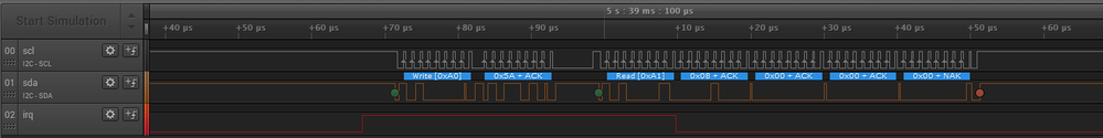

Our cDB board works nicely connected to the ST25R3916-DISCO via SPI. However, when connected via I2c to our STM8 motherboard (I2C_EN pulled to VDD_D) the cDB does not acknowledges the 50h address. It just behaves as if 50h were not the correct address.
We have checked with a logic analyzer and a scope. The ST25R3916 does not pull the SDA line.

Address 50h is the 7-bit address of the device. Therefore the byte #1 of the I2C frame (I2C Address Field) has to be A0h (Write) or A1 (Read). Can you connect a logic analyzer and check that the I2C Address Field is correct?
By the way, the RFAL is scalable: in particular if only one technology is used (e.g. NFC-A), other technologies can be disabled and this significantly reduces the memory footprint.
Rgds
BT
it should work, for reference I am adding a shot from a working i2c. 0693W00000UFP19QAH.pngI assume you are using official samples, no samples marked as ES (Engineering samples) ?!
Best Regards, Ulysses
