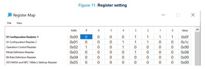

Hello again Ulysses,
unfortunately, I cannot see any reduction in the power output, and also, using a spectrum analyzer, I saw a weird peak around 27.12MHz (which is both the second harmonic and the frequency of the XTAL we are using).
I am afraid that I am doing something wrong in the other registers. When re-flashing the chip I started fresh with the configuration suggested in the AN5592 for the differential antenna as shown in the image:
It does not add up to me, however, that by changing the parameters you suggested in the previous response, from the Spectrum Analyzer, I see no significant difference. Do you have any suggestions on what to do?
If, by any chance, I am doing something extremely ***, I attach here the register's content of the chip to complete the description of the problem.
Thank you for your time.
Sincerely,
Luigi

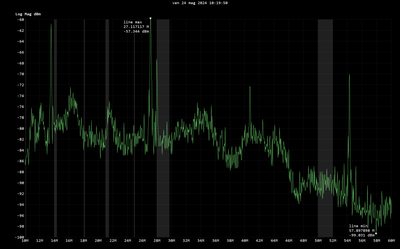

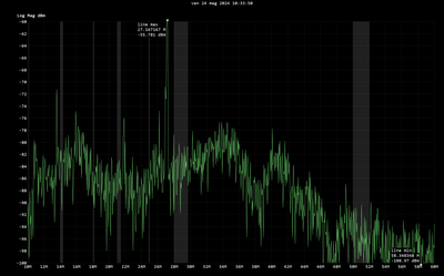

Hi Ulysses,
I acquired some pictures of the Spectrum Analyzer so that you are able to see what's going on. I also saved the registers' content while coupling between tag and reader was happening so there should be no unexpected values in the registers.
Just to give you a bit of context, I am using a passive NFC tag with a ISO/IEC 14443-3 Type A  based interface.
This is what I can see from the Spectrum Analyzer when 0x2A = 0xC0 , 0x27 = 0x7F (scenario1):
While this is what I saw on the Spectrum Analyzer when 0x2A = 0x00 , 0x27 = 0x00 (scenario 2)
 I will attach both or registers' content marking them with scenario #.
Thank you for your time Ulysses, I appreciate it.

Hello Luigi,
I don't know why your 2nd harmonic (27.12MHz) is so high.
You can see a nice reduction on 13.56MHz from -61dBm to -71dBm.
How do you connect the SA to the PCB? If you are probing at the RFO directly, it is quite clear to me. The chip is outputting a rectangular signal, which is converted by the EMC filter into a sinus.
The easiest way of confirming the output power and output power reduction is to measure the antenna voltage via a scope. Additionally i would recommend to verify the RFI voltage to be max 3V (idealy around 2.5V to 2.7V).
Please let me know, if this helped.
BR Travis

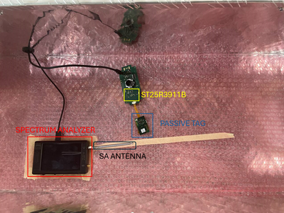

luigiantuono
Thanks for your answers,
I am going to answer back in chronological order. So starting from @Ulysses HERNIOSUS :
- The tag is in the reader field during the dump of register's content while the reader antenna is a custom printed antenna. I am sure of the correct NFC pairing between the passive tag and the reader cause I set a blinking led feedback on the custom printed PCB that host the ST25R3911B.
- I am measuring the spectrum using a SA as in the setup shown in the attached image:
The setup is installed inside a metal box.

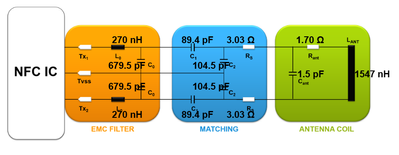

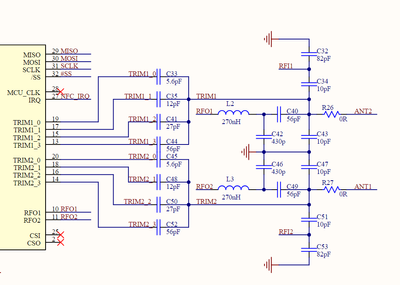

I am quite sure that this partially answers to @Travis Palmer 's questions anyway I would like to give to you some more details regarding the HW configuration we used for the ST25R3911B. This is only becauise now my main issue is to reduce the power associated to the second harmonic of the signal. After that I weill go on with the lowering the output power of the chip itself.

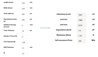

Assuming that we are using an antenna (for the NFC) that has this characteristics:
Using then a tool for the antenna matching I found out that the suggested matching circuit is this:
Which is not that different (at least for the EMC filter) with respect to the one used on the custom PCB I am referring to, which is the following:
So, assuming that the coupling circuit is well designed (I hope that makes sense to you as well), my final guess to try to solve the problem involves AM modulation.
In both scenario1 and scenario2 files that I attached to my previous message, I saw that the contents of register 0x09 has bit 5 set to zero. This implies OOK modulation which in the case of an ISO/IEC 14443-3 Type A tag is not working properly.
I was wondering, the Analog preset command, from the information obtained from the configuration register (0x03) should automatically set the correct modulation type for the specific tag but this does not happen. Assuming this is the problem (I'm not sure because I don't know for sure how the chip behaves and whether it changes the settings and then resets them with each coupling cycle), could you help me understand this properly?
Also, if you find any obvious issue with the HW matching circuit please let me know because it seems fine to me and I don't want to go in the wrong direction keeping you busy with my questions.
