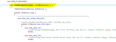

Now I'm stuck at
case DEMO_ST_DISCOVERY:
if( rfalNfcIsDevActivated( rfalNfcGetState() ) )
I'm getting RFAL_NFC_STATE_POLL_TECHDETECT:

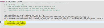

could you enable ST25R_SELFTEST and ST25R_SELFTEST_TIMER compilation flags?
Which tag (manufacturer and model) do you use for your tests?
Could you check with a scope that the RF field is on?
Rgds
BT
Hello
I Enabled Self Test, going to error platformErrorHandle();
RFAL_ERR_SYSTEM 8
Im using a card ISO 14443-3A by NXP- MIfare Clasic
I don't have any equipment to check RF Filed
Vinod

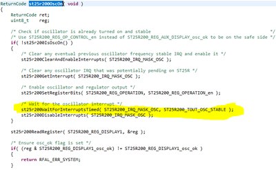

could you check the implementation of the following macros in rfal_platform.h:
  • #define platformTimerCreate( t )
  • #define platformTimerIsExpired( timer )
  • #define platformTimerGetRemaining( timer )
  • #define platformDelay( t )
  • #define platformGetSysTick()
See an example of rfal_platform.h in polling demo in the ST25NFC_Embedded_Lib_ST25R200 package.
Rgds
BT
attached the timer file
Brian TIDAL
I suspect that the system tick is not configured correctly.
How is the system tick being implemented in your application? Could you check that the tick is regularly incremented? Could you toggle a GPIO for 50ms using HAL_Delay(50)  and check the output with a scope connected to the GPIO?
