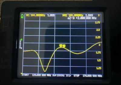

- then you can check, what the antenna is doing:
....where is the main resonance .
Without any measurement...its just rolling the dice.
