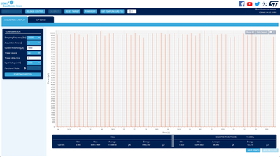

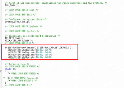

I am testing power consumption. The hardware is using nucleo-L476 and X-NUCLEO-NFC08A1, and the software is using the NFC06A1_PollingTagDetect routine from X-CUBE-NFC6. The test revealed that the average power consumption was 180 uA when entering the wakeup. I was using a 3.3V power supply. The minimum current is 40 uA.
I'm not sure how to make the necessary modifications to achieve the description in AN5320.

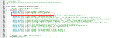

  2. Set driver to high resistance (d_res=0xf), e.g. write register 28h to 0x0f.

Hi
 Thank you for your reply.
Based on the register configuration in the data manual, the current under this configuration is over 40 microamperes. Is there any hardware modification required?

Hi Ulysses HERNIOSUS
Thank you for your suggestion.

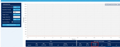

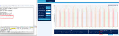

I remove the varicaps and The configuration of rfalAnalogConfigCustomSettings array. The power consumption of the current 200ms wakeup mode has been reduced to 36ua.

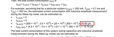

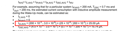

To achieve 25ua in AN5320, do you think there are any other possible modification points? Or do I need to adjust the NFC matching network?
Hi ShimiaoWang,
the IA,AVG cannot be directly measured. What you are measuring is the overall average current which always includes also IWU and IOSC,AVG
(typo: IOSC,AVG missing before IWU).
BR, Ulysses
