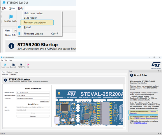

Hi MelioNB,
After installing the EVAL GUI you can navigate to the example folder and also browse the Protocol description between the PC and the board. See below:
Using the APIs provided one can issue individual commands/frames at will.
In your case, for ISO15693 / NFC-V a plethora of commands can be performed, eg:

A ready to use Python example is available, but unfortunately currently the GUI Installer STEVAL25R200SA (v1.1) seems not to contain it. We'll try to update the package meanwhile.
