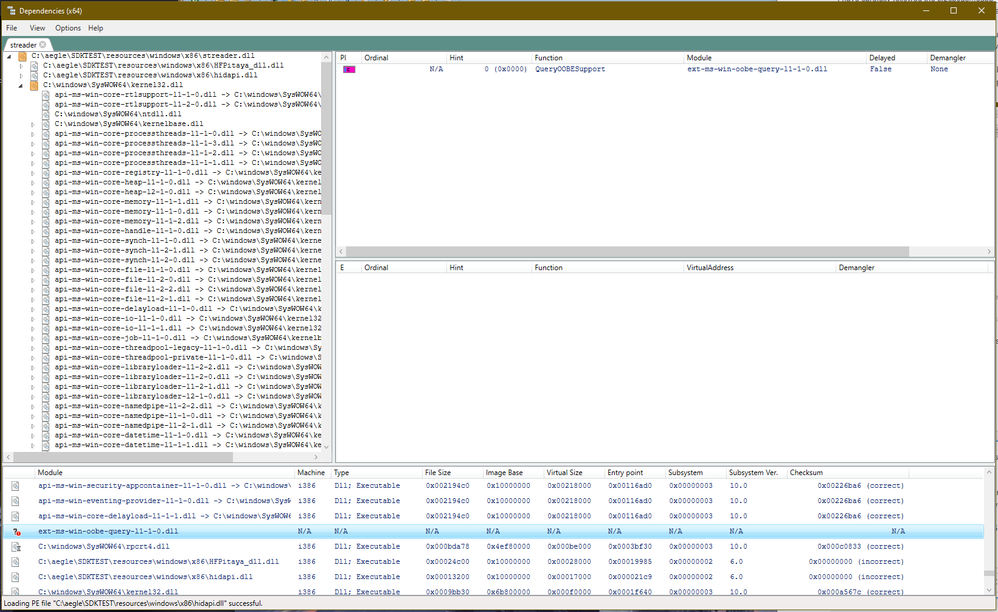

Hi! I am attempting to use the current 1.10.0 Java SDK on a windows 10 pro computer with JDK 1.8.0_144. (Java 8) x86 - for use with ST25R3911-DISCO at first, and hopefully then the Feig USB reader.
0693W00000NqQU3QAN.pngI have carefully followed the st25pcdemoapp_...pdf document as well as created my own simple demonstration [pictured] and gotten the same result: "streader.dll: Can't find dependent libraries"
I have found the 2020 post with the same issue, and the linked zip file does not fix the problem. I have now used dependency walker to attempt to hunt down what is missing, which can be seen in the attached screenshots.
It appears there are a bunch of windows 10 SDK dlls that are not found, but I am so far unable to figure out where to find them to install them. The microsoft KBs appear to be for prior versions of windows.
Any advice on resolving these dependency issues?
Thank you!

Upon more research it appears those are not real errors, and the popular dependency walker program does not work with windows 10.
I have found a more modern program called 'Dependencies' that seems to indicate only "ext-ms-win-oobe-query-l1-1-0.dll" is missing - which maybe isnt what is causing my issue?
I am suspecting maybe this is a x86 vs 64 bit DLL issue? Thanks in advance.

Oh. I should have mentioned, I did install those. I have opted for the 2015-2022 distribution that has all of them. Attempts to install just the 2017 MSVC fail with the error "already installed".
I suppose in my desperation I may try and remove the other ones and just install the file that is included in the resources folder of the SDK.
Interestingly, if I double click st25PcDemoApp.jar in the file explorer, it briefly flashes and closes without ever seeming to run, but if I navigate to the containing directory and type "Java -jar st25PcDemoApp.jar", it runs, but only if I copy the contents of the ST resources folder to the containing folder.
I see that eclipse is executing the code with Javaw - but this should not be a difference, its the same java installation as far as I can tell.
Very frustrating at this point. Spent all weekend on this and still no dice. RIP.
