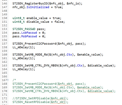

I have a really weird behaviour for my chip which I can't really figure out. Basically, I am using only the commands from the ST25DV library (st25dv discovery board).
After 2 function calls (for example present password and disable RF) the subsequent calls get all not acknowledged.
If I reverse the order of the instructions then those instructions will get executed correctly and the other ones won't.
Could someone provide a hint on what could go wrong?

I would be glad to share my code:
Perhaps I should mention that I've been wrapping the SD25DV calls with my own I2C LL implementation. However, I didn't have different results with the HAL implementation either, and regarding the protocol the data on the wires seems to be alright.
I am suspecting I am using the User Layer of the ST25DV in a wrong way. Can you confirm that ?

Rene Lenerve
November 2, 2023
Hi @robertp,
First comment, could you please use code sample tag for the shared code it will ease the exchange.
Second comment, be careful converting boolean to integer, false and true could be defined as
#define false 0
#define true !false
and in that case !0 isn't 1.
For ISO C99 defined value of false and true are 0 and 1 (but in certain environment it could be something else)
Third comment, I'm sure you're doing correctly but in your capture ResetRFDisable is commented due to a missing comment tag */
From what you've shared I don't see anything wrong, be careful to have correctly set nfc_io structure for
ST25DV_RegisterBusIO
 nfc_io.Init = BSP_I2C2_Init; //to adapt in your case
 nfc_io.DeInit = BSP_I2C2_DeInit;
 nfc_io.IsReady = BSP_I2C2_IsReady;
 nfc_io.Read = BSP_I2C2_ReadReg16;
 nfc_io.Write = (ST25DV_Write_Func)BSP_I2C2_WriteReg16;
 nfc_io.GetTick = BSP_GetTick;
Do you have also this issue when you compile and run the ST25DV-DISCOVERY demo?
If you still have the issue, maybe you could share more of your project to determine where the issue is.
