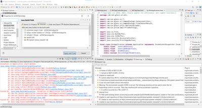

I added the highlighted code (page 24) from the guide to the MainApp.java but there were few errors showed (photo attached: import packages cannot be resolved.png), such as, "The import com.st.st25pc.model.rfReaders cannot be resolved".
Regardless I used my java project or the given "st25PcDemoApp example" inside STSW-ST25SDK001 File, both showed the same errors.
Now I can't import the wanted data into the MainApp.Java, so I was unable to write a simple NDEF File into the tag.

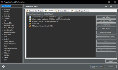

From your screenshot it looks like the STReader library locations have not been specified in the Java Build Path settings. Check that the Libraries tab contains the correct path to the st25sdk and reader libs (to use with ST's ST25R95, ST25R3911B-DISCO and ST25R3916/B-DISCO boards) as shown below:
I invite you to check the st25demoapp Eclipse project in the integration\pc\examples\st25PcDemoApp directory.
This project runs the same code as in the user guide and you will be able to check the library paths in the Java Build Path menu.
You can find the latest ST25 sdk version (1.10.3 today) at: https://st.com/st25sdk

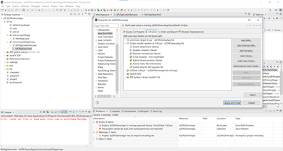

Good evening Damien, thank you for the reply.
I downloaded STSW-ST25SDK001 from the link you provided, and I had discovered some errors after I launched st25DemoApp.
The original file was using 1.9.0 jar, it will show there're missing libraries
So I changed to 1.10.0 jar and tried to run the program again and it showed me a new error,
I'm using ST25R3916 Discovery Kit, may I know will this reader work with the code if I ran it successfully?
