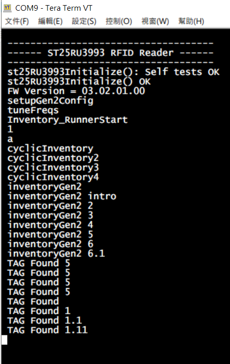

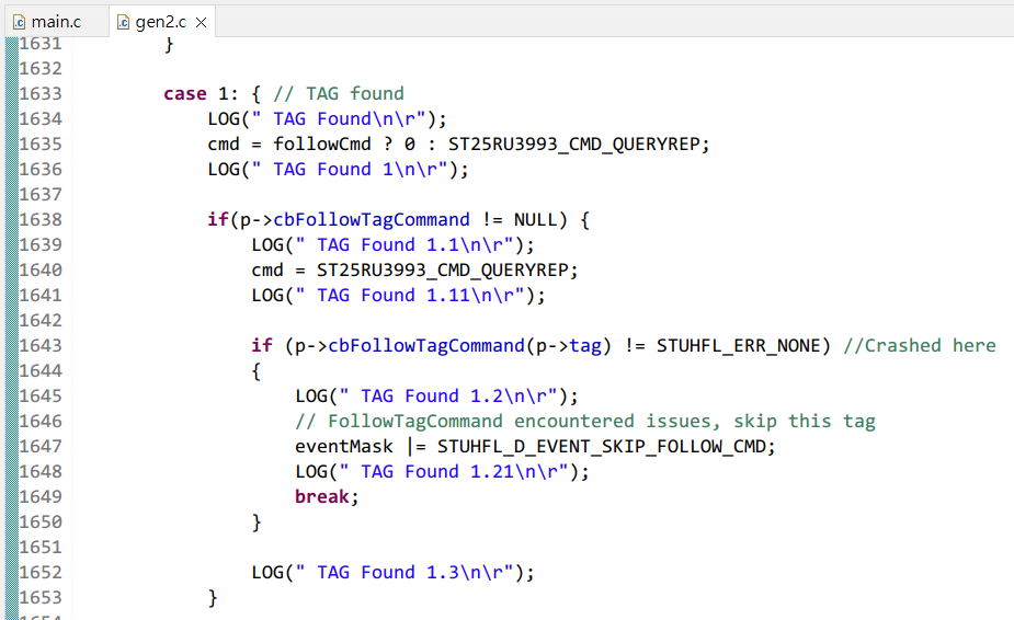

Dear Nick,
I've successfully booted the EVB by set DTR to low and toggle RTS low - high and enabled the device mode, thank you so much for help me to solved this issue.
But here is an error occurred, as the following picture, the EVB crashed when it found tags and executing this code:
if (p->cbFollowTagCommand(p->tag) != STUHFL_ERR_NONE)
I didn't edit the firmware except enabled the STUHFL_DEVICE_MODE in main.c, and more weirdly, it just works fine the day before the error occurred, I want to know what happen with it, thank you.
Nick K
I can not reproduce your issue. To test I used the HPEV board with the antenna and tags from the package and can read the tags without any issue.
From your screenshot I see that you use V3.2.1, which is ok.
Does it still crash for you ?
When it crash have you already tried to debug and checked the call-stack and the value of involved data fields ?
One comment. From the screenshot I can see that you added multiple LOG statements inside the file gen2.c.
The function gen2SearchForTags(..) handles the Query/QueryRep loop for inventory. This section and the called low level function here are timing critical.
Each call to LOG use a blocking call to the HAL driver to log data out over the UART. This will not crash the FW but slow down the inventory.
BR Nick
