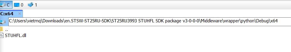

It is asking for .dll lib file.
but in the SDK, the .dll lib file is located under : en.STSW-ST25RU-SDK\ST25RU3993 STUHFL SDK package v3-0-0-0\Middleware\wrapper\python\Debug\x64
should i change the library path in the python code or what should i do in this case ?

The DLL is supposed to be found by the MW thanks to the code in STUHFL_demo.py dealing with os.path (lines 27-43) + the function loadSTUHFL_DLL() in STUHFL_native.py.
So the current location of DLL (...\Middleware\wrapper\python\Debug\x64) is OK,
now remains to understand why in your environment the DLL is not reached:
FileNotFoundError: Could not find module 'C:\Users\vietmq\Downloads\en.STSW-ST25RU-SDK\ST25RU3993 STUHFL SDK package v3-0-0-0\Applications\STUHFL_demo_wrapper\STUHFL_demo_py\STUHFL_demo_py\Debug\x64\STUHFL.dll' (or one of its dependencies). Try using the full path with constructor syntax.
...\Applications\STUHFL_demo_wrapper\STUHFL_demo_py\STUHFL_demo_py\Debug\x64\STUHFL.dll is definitely not the path where the dll is supposed to be found !!!

Another point, looking at your traces it seems the dll is eventually found (indeed cdll.LoadLibrary(libPath) is called after the check if os.path.isfile(path + "\\" + libPath):)
but has a problem to load, so could you check the bitness (32/64 bits) your system is using ?
Indeed, we provided with the release package only the 64 bits debug dll
but if your system is 32 bits only you will have to build the equivalent dll for 32 bits support.
If your system is still 32 bits, could you then try to rebuild the dll ?
Please have a look to Application-STUHFL_demo_py.chm for further details on how to (re)build the dlls.

Hi @Cedric Dalban​
Thanks for your support.
I have modified a bit in python code :
def loadSTUHFL_DLL():
    # Checks DLL exists and is reachable
    for path in os.environ["PATH"].split(";"):
            print("aaaaaa:: " + path + "\\" + libPath)
            #return cdll.LoadLibrary(libPath)
            return cdll.LoadLibrary(path + "\\" + libPath)
    print("""
***************************** CAUTION *****************************************
Cannot open STUHFL DLL:
Please ensure STUHFL DLL has been generated before using STUHFL Python wrapper
""".format(libPath))
    sys.exit()
    return None
I returned "return cdll.LoadLibrary(path + "\\" + libPath)"
with this modify, the python code work well in my window computer.
