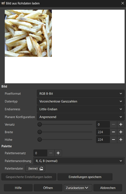

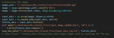

Hello, I'm writing my bachelor thesis regarding the deployment of the model inside the STM32, and I just want to use CubeIDE to run my own program. It takes in the image data through the UART, put the data inside the model input buffer and then do the LL_ATON_RT_Main(&NN_Instance_Default); and finally gives out the ourt put.
I really did everthing I can, I already wrote the parameters generated by the Cube AI in side the External flash (exactly same place as the cubeAI report, which is 0x70000000 ). The model is from offical website:  mobilenet_v1_0.25_224_fft_int8.tflite .
the file is from the Neural ART(cube AI) the origianl name is network_atonbuf.xSPI2.raw, I copypaste it and rename it to .BIN so that I can download it with the cube programmer instead of using the cmd lines or some python files of the Neural ART.
After that, I run my program, below is my ST program ,It works without any "wornings or bugs",I can inspect the output by monitoring the float buffer[101] with debug mode.The input data is also exactly the same with the PC side, I even wrote a CRC test for it,and I tried many ways and made sure that its exactly the same!  But the output is very different from the model I run inside the computer (see the part after the code):

However, my problem can still not be solved by this. The image format have no problem.
I used these Python lines to output a .data file and inspect it with the GIMP, (there is only this RGB 8bit choice), and GPT said that its the same with RGB888. It turned out that the picture is not 'twisted' or with the wrong colour (at least with huamn eyes...)
So I think it might not be the problem from the data side...

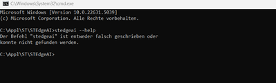

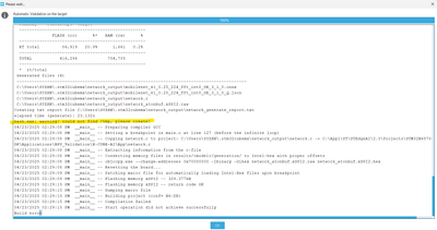

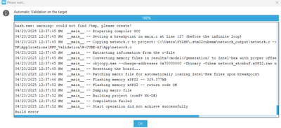

But I got a problem when I tried to validate it. I set the config.json file with the right path, but my board is N6 Nucleo, so it some how can not proceed with validation, cause default is for the DK board, do you know where I can change the config?
I can find the documentation here ST Edge AI Core - Command-line Interface
but i dont know how to change to N6 Nucleo or how to use cmd to work this.
So, I guess its because of the Board is wrong, I am using the Nucleo N6 board. (just a guess).
I tried cmd, but looks not working. (humm, I know I should do sth. instead typing this... but I dont know what to do)
Could you give me ideas how to fix them?

April 23, 2025
Hello @Einstein_rookie_version,
If you look at my first screenshot, you will see that I used the Nucleo N6 to do it.
Create a new cubeMX project just to do the validate:
  1. Open cubeMX
  2. Click Board selector
  3. look for the Nucleo N6
  4. I select secure non secure
  5. Unselect all and click ok (I don't know if it does something, but the less the better)
  6. Activate X Cube AI and select the validation template
  7. I click no when asked to automatically optimize clock and peripherals for performance
  8. select model
  9. Click on validate on target
  10. Port com auto, baudrate 921600
  11. Enable automatic compilation and download, select STM32CubeIDE (first screenshot in my last message)
  12. plug the board with usb C to usb C data cable
  13. ok
For the location of the stedge ai core, I think, if you installed it with cubeMX, it is located here:
C:/Users/YOUR_USER/STM32Cube/Repository/Packs/STMicroelectronics/X-CUBE-AI/10.0.0/Utilities/windows/stedgeai.exe
