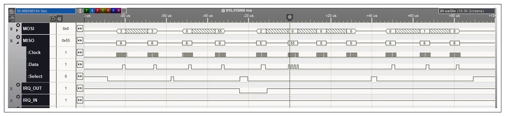

Also, I would suggest to connect a logic analyzer on IRQ_IN, IRQ_OUT, SPI_CLK/MOSI/MISO/SS, SSI_0, SSI_1 and to send me the trace of the initialization sequence and SPI communication
Example of commands
0693W00000HrAeZQAV.jpgFirst frame: 03 XX SPI Poll. Answer is XX 06 ==> bit #2 =1: data can be sent to the device
2nd frame: 00 55 : Send Echo command
IRQ_OUT goes low
3rd frame 02 XX XX XX read Echo response
4th frame 00 01 00: send IDN command
Rgds
BT

Thanks for the very thorough response. I have attached my logic analyzer tests as well as a screen shot of my Python test Script. As you see from the script, I've created code to buttons so I know what is sent and when.
I'd like to respond here to some of your suggestions:
(1) Clock probe. I do not see the response with my oscilloscope when I probe the clock as shown in Figure 3 of your link. Its mostly noise.
(2) I never see anything on IRQ_OUT. The logic analyzer shows that it is always low.
(3) Section 4.1.1 of the datasheet says that CPOL=CPHA=1 or CPOL=CPHA=0. I tried both of those. Based on your suggestion, I also tried CPHA = 1 and CPOL = 0. I saw no change in performance (or lack thereof).
(4) MISO and MOSI are properly connected (see attachments)
(5) SS is being set high between commands (see attachments)
(6) The chip is not responding to the any command, including the echo command.
So I'm still not able to talk to this at all. This is not the first time I've communicated to something with SPI, so I'm quite confused as to what could be the issue. I have confirmed power is getting to the IC holder. I loaded my 3rd IC into the holder for these tests (just in case I fried the previous 2 IC's.) I ordered another 3 just in case I have damaged these 3, but I am at a lost right now as to what to try.
