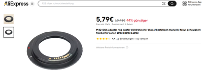

I ordered EF confirmation chip with adapter (I needed that adapter), If flash dump is possible.
Something like this ?
AF-confirmation chip
So to work with this strange SPI ,(if your description is 100% correct at all), you have to write the "spi/i2c" yourself, to to meet all requirements.
Info here - you found obviously : https://gist.github.com/marcan/858c242db2fc595da1e0bb70a05192fc
Seems not so difficult...
...but then : for doing ..what ?  make a copy of these $5 Adapter ? Or build a new one ?
