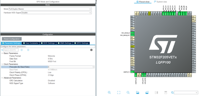

Hello everyone,
I try to connect the Nucleo-NFC08A1 board with a STM32F205VET6 via SPI. I'm also using the X-Cube NFC6  software extension and tried polling.
                   STM32F205VET6            NUCLEO-NFC08A1
SCK:           PC0                           -     ST5 (Arduino Connectors)
MISO          PC1                           -     ST6 (Arduino Connectors)
MOSI          PC2                           -     ST7 (Arduino Connectors)
/SS             PD0                           -     ST7 (Arduino Connectors)
IRQ            PD1                           -     ST7 (Arduino Connectors)
I know its required to change the ports in platform.h but I could not found it. Can someone help me? Is there something else to change ?

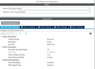

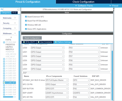

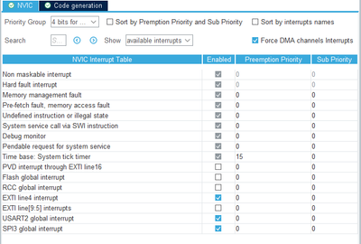

if you have used STM32CubeMX and the X-CUBE-NFC6 3.0.0 package and configured this through STM32CubeMX, there should be no need for modification. For example:
Can you elaborate more on your issue: is it a compilation issue or an execution issue? If it an execution issue, have you properly configured the PD1 as GPIO_EXTI1 and enabled the EXTI Line 1 interrupt in the NVIC configuration?
I would recommend to set the ST25R_SELFTEST and ST25R_SELFTEST_TIMER compilation switch and make sure that st25r3916Initialize returns no error.

Hi BT,
it's more like a execution because i tried to analyze the SPI with an Logic Analyzer and I don't receive any data.

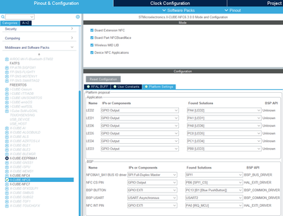

The Programm get's stuck when it tries to check the st25r3916CheckChipID(). It wants to read the Identyty register but did not get any value back.
