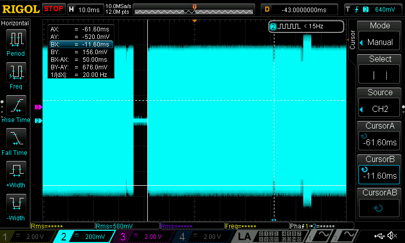

adambartyzal
thank you Brian for your reply.
It's a transportation card. Namely "Yélo Card" from french city La Rochelle. Here's what TWN4 says about it:
ISO14443B ~ UID Length 32 Bits ~ UID HEX C30ABADD
Which is why i believe it's a type B card. Also, the sniffed message comes right after WUPB command as seen on screenshot from osciloscope:0693W000005AIOzQAO.pngabove is a recording of communication with the twn4 reader since RFon to the card response. The first modulation of the carrier is WUPB command (which I believe is a REQB with 0x08 as a parameter) and just 10ms after comes the x000B3F80 (I miss-typed previously F for B, sorry for that, both produces an answer by the way, probably it's only a parameter).
edit: new observation:
no WUPB is necessary to initiate the answer, so maybe it truly isn't Type B card afterall.
I need to read this particular Yélo card type though, what ever the type is.
another edit:
After several hours of searching the internet I'm now almost sure the card is one of Calypso Cards which uses Innovatron protocol. So my new qusetion is. Is it possible to use CR95HF with that protocol?
Brian TIDAL
such public transport tags often use modified ISO14443B framing and are therefore not ISO14443B compliant.Thus, such tags are not compliant with CR95HF reader.
Can you give more information about your application and why you need to support this particular tag?
Rgds
BT
