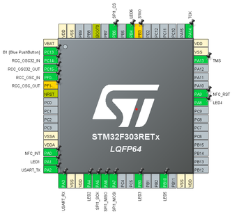

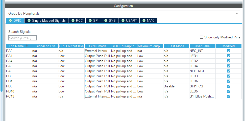

I would like to develop a system using the NFC chip ST25R200 and the microcontroller STM32F303. The main idea is to be able to read an NFC tag, specifically the ST25DV64KC.
As a first step, I plan to test this using the prototyping board NUCLEO-F303 and the NFC expansion board X-NUCLEO-NFC10A1. I'm using CubeIDE.
I'm sure that ST has prepared everything for a simple and smooth integration. Because of that, I'm confused about what I'm doing wrong.
After configuring the pins and integrating the middleware/software in STM32CubeMX, I get errors when I try to compile the code (I haven't changed anything in the generated code).
Here is picture with Pins defined:

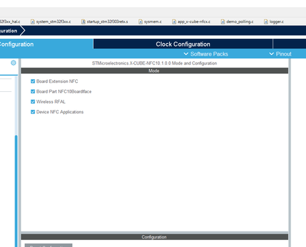

here is Middleware/software package included and set:

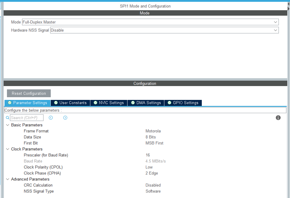

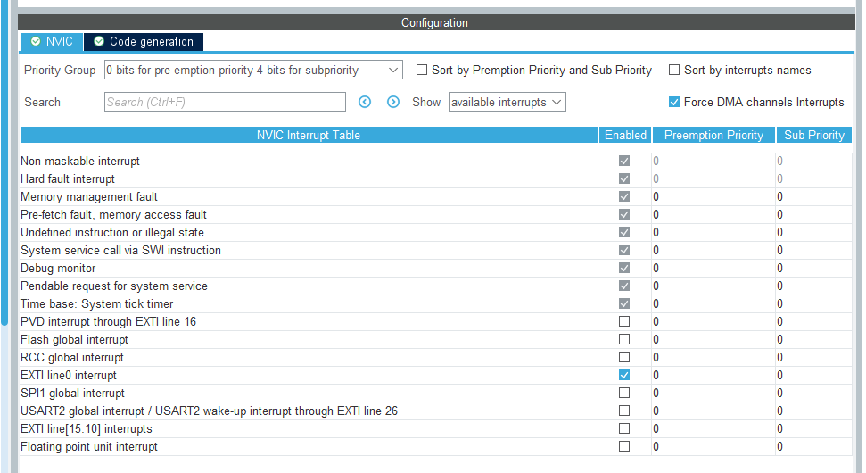

SPI1, Interrupt, GPIO configure:

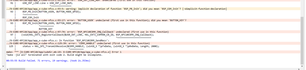

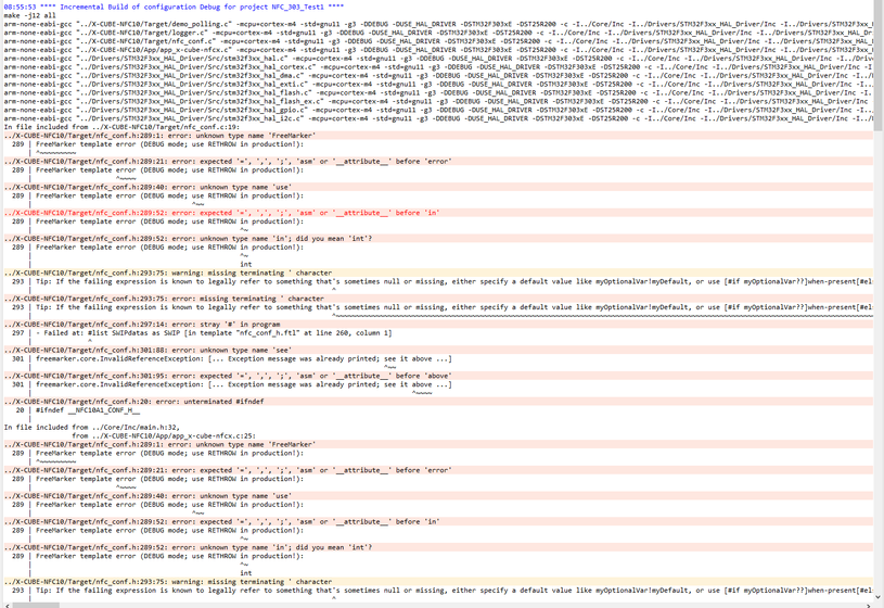

After generating code I go to main.c where I want to compile generated code and get a lot of errors:
Can you please help me understand what I'm doing wrong?

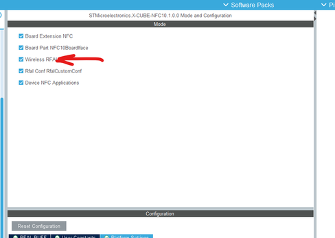

Brian TIDAL
make sure to select an RFAL configuration. It seems not selected in your case:
This should be something like:
See attached ioc file as an example.
Rgds
BT

That solved my problem.
Thank you very much.

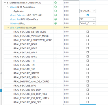

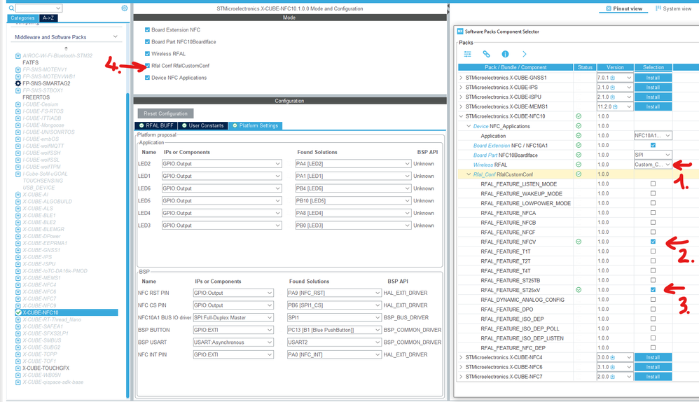

If I want to use NFC-V and allowed energy harvesting for tag (ST25DV64KC)...
1. what is the minimum of the functions I need to use?
2. what of these options I need to use:
I'm a bit sceptical with time spending using all that functions.
Thank you and best regards,
in a perfect world, you should choose Custom_config for the RFAL and then select RFAL_FEATURE_NFCV and RFAL_FEATURE_ST25xV and regenerate. In that case the project also defines RFAL_ANALOG_CONFIG_CUSTOM whereas no custom analog config are provided, so #define RFAL_ANALOG_CONFIG_CUSTOM needs to be manually commented in the nfc_conf.h.
Unselected technologies are then not used in the discovery loop and the linker removes the unused part of the code.
Rgds
BT
Thank you.

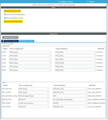

So I did the following 4 steps:
Is this enaugh or I need to uncheck some other things? thank you very much
If I do this 4 steps and compile code I get no errors.
Best regards,
this should be fine: only NFC-V technology plus support of ST25TV/ST25DV API are selected.
Rgds
BT

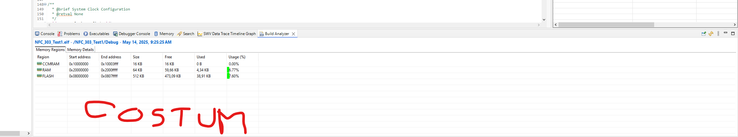

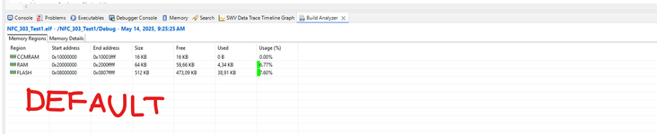

Okey, but with this configuration I don't need to insert #define RFAL_ANALOG_CONFIG_CUSTOM like you said.
If I check RAM, FLASH usage are in both cases the same:
I have a feelings like nothing changes.
Should I uncheck what the bottom red arrow shows or anything else?
thank you and best regards,
Brian TIDAL
Sorry for the confusion about RFAL_ANALOG_CONFIG_CUSTOM, I was using a pre-release version of the FW package.
Regarding RAM/FLASH usage
Default:
Custom:
Make sure to use the following compiler settings:
and the following linker setting:
Check the map file for the custom build vs the default build: functions such as rfalNfcaPollerInitialize should be absent in the custom build map file.
Also adjust the compiler optimization level according to your needs.
