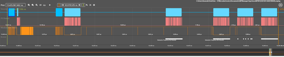

the typical NFC Forum collision resolution process includes a 1-slot Inventory followed by a 16-slot Inventory in case of collision has been detected during the 1-slot Inventory. Further 16-slot Inventory commands may follow when further collisions are detected.
Here a typical sequence with 5 tags in the field of a ST25R3916B reader:
In dark blue, the Inventory Requests and in light blue the Inventory Responses. The 1st command is a 1-slot Inventory followed by collisions (5 tags replying). The 2nd command is a 16-slot Inventory followed by 5 answers in slots 1, 5, 7, 8 and 9 without collision.
So basically the inventory speed is not reader dependent. Without collision during the 16-slot Inventory, one can expect to detect 5 tags in ~90ms if one of the tags replies in the last slot. In case of collision, further inventory commands are needed.
Hope this clarifies.
Rgds
BT
Thanks for the details! The 90ms for 5 tags speed should work perfectly for my needs. Really helpful to know that inventory speed isn't reader-dependent.
