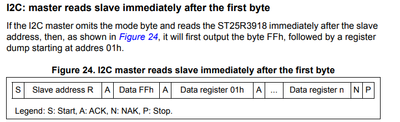

Hello Brian,
     Thanks for your reply.
      Yes I have checked the datasheet and tried also with this sequence:
#define ST25R3918_ADDR 0x50  // Replace with actual I2C address
#define CHIP_ID_REG 0x3F     // Replace with correct register for chip ID
#define INIT_REG 0x02        // Example register for initialization
#define ST25R3918_CMD_MODE              (3U << 6)                      /*!< ST25R3918 Operation Mode: Direct Command                       */
#define ST25R3918_READ_MODE             (1U << 6)                      /*!< ST25R3918 Operation Mode: Read                                 */
Wire.beginTransmission(ST25R3918_ADDR);
  Wire.write(CHIP_ID_REG | ST25R3918_READ_MODE);  // Request chip ID register
  Wire.endTransmission();
  Wire.requestFrom(ST25R3918_ADDR, 1); // Request 1 byte
  if (Wire.available()) {
    byte chipID = Wire.read();
    Serial.print("Chip ID: 0x");
    Serial.println(chipID, HEX);
for using mode byte as well. I have checked st25r3916 drivers in stm32cube to see how to do it.
I am also using direct command C0 and C1 in order to have the chip  in ready or stable state:
#define ST25R3916_CMD_SET_DEFAULT 0xC1U /*!< Puts the chip in default state (same as after power-up) */
it seems that even though I set mode byte what I read is for situation described here:
so it seems mode byte is ommitted even though I set it

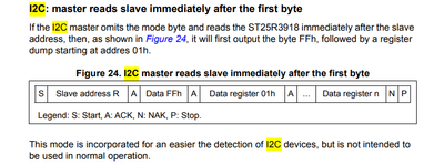

Hello BT,
    Thanks for the suggestions.
    Wire.endTransmission() returns 0 so it's ok.
    I can read chip ID reg(0x3F) and any reg for ST25R3918 but only in this mode(when doing a dump of registers):
even though I send byte mode according to the datasheet and the Wire.endTransmission() afterwards returns 0(transfer completed)
Actually the issue was that both Wire.endTransmission() and seemingly the st25r3918 driver from stm32cubeIDE are setting a STOP bit after first part of i2c transaction(when the master writes the register address it wants to read)
maybe repeated start is not implemented correctly in the driver. I will check it
Testing with Wire.endTransmission(false) helped me understand what the issue was
Thanks for the good tips. will close the topic
